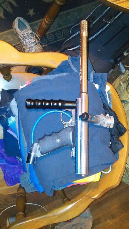

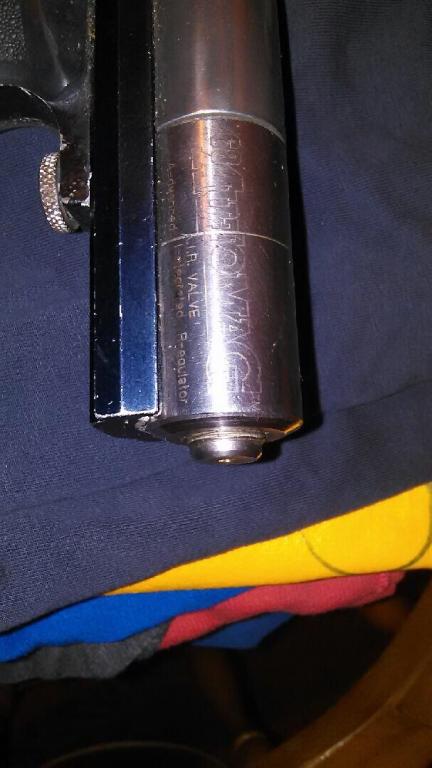

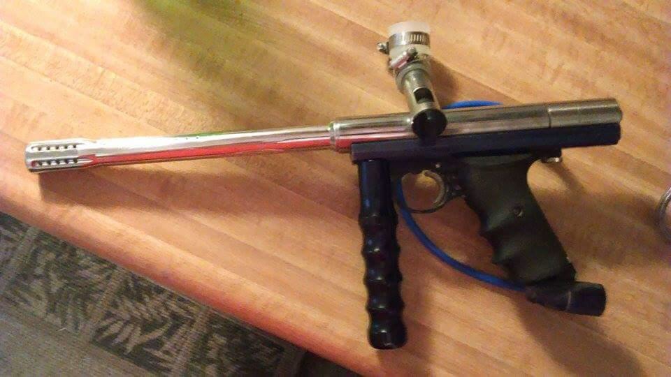

    I just picked up a 68 classic automag. I've done some research, but still know little. I was wondering if someone can tell me more about it? I plan to make it a project gun (ultimate goal of no external macrolines), but want to know what my starting point is. I guess the rails, grip frame, valving, and bodies can be different so I'd like to know what I have.

    Standard automag with classic valve. Nothing special. It's about as base model as you can get.
