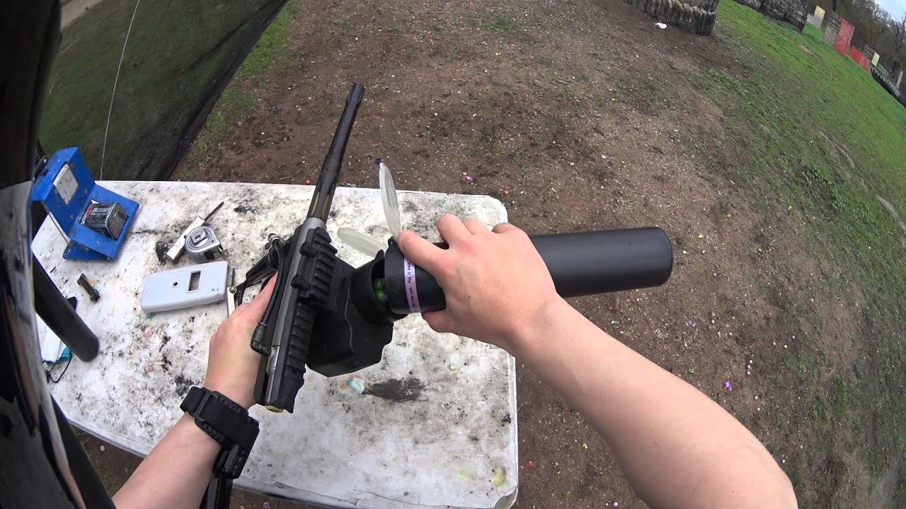

    So uh... this started as a joke but... I think this might actually be useful. If I want to vary detent performance, I can go from 1 detent all the way to 7, all in the same adapter...

      that's pretty cool
      whats the material?
      • blackdeath1k
        • 2436
        I'm curious how that holds up. And works. Color me intrigued.
        • GoatBoy
          Junior Mint
          • Jun 2003
          • 1399
          Just normal PLA for the adapter and Ninjaflex for the detent. I am a simple man of simple means.
          Manually cycling it, it works just fine, except it seems the recovery time for the rubber isn't as fast as a spring detent. Might not matter since it has to wait for the bolt to clear all the way before a new ball can even load in.
          I think everything else, including durability, will pan out.

                          Technically, Lil Stumpy was just the first test piece to house the new system.
                          Anyways, for those not up to speed, this is pretty much like Docs mag to cocker adapter.
                          I think I'm going to call the new adapter “The Cold Fusion”, with Dual Sphincter™ Technology.
                          I ran about 200 rounds through the Bunamag with three Adjustable Sphincter Detents installed against a Rip Clip at the highest settings. No double feeds; also tilted the gun down and shook it a bunch. Paint size was about .685.
                          Recovery time seemed sufficient, zero observable wear on the detents, and I still had space for 4 more to be installed.

                            Very nice setup!! I need somebody to print a 3/8" tail to fit over my ion body so I can run my armson sight off the right side of the body
                              #29
                              new or old style rip clip?
                              and that pic rail on top what is that off of , and how is it attached?
                              you gave me so many ideas.
                              this will be fun this summer.
                              if I can go to tunaball I'm going to try to make as many parts as possible and bring them with me.
                              • GoatBoy
                                Junior Mint
                                • Jun 2003
                                • 1399
                                #30
                                I like what you did with that Mini reg; been planning something similar for a pump gun too. How are you getting the air? Through the top with an adapter?
                                The 3/8" rails are kinda small; not sure if I would trust those to be 3d printed (Picatinny is nice and large). I think the rail part proper should probably be metal, but the rest of the mating adapter could be 3d printed. I am not familiar with Ions at all though.
                                I.e. get some of these:
                                and mate them to your body.
                                Uhm... there are different Rip Clips? I'm thinking this might be a "newer" model. I only use it for testing or when the spring feed might be too exposed to elements.
                                Top rail is from an Empire Trracer. Good ol' fashioned epoxied that sucker right onto the steel body; couldn't find any other way to really attach it. Need someone to put weld nuts on the top of my body and all my crap will have a nice hard mountpoint.
