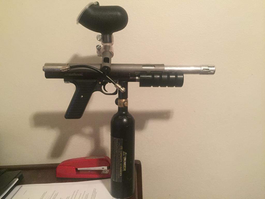

    I played my first game ever with a stock class gun, my Phantom, the other weekend and now I'm hooked! I loved playing with 10 round tubes and a lighter, smaller profile configuration. This has inspired me to convert my pump minimag to modified stock class or something similar. I'll be running constant air into a vertical ASA. As for the type of paintball feed that will go on the gun, I'm still undecided, so I figured I'd share some mockups of the five different limited-ammo configurations of which I'm currently deliberating:
    - 50 ROUND HOPPER
    This is my gun as of right now, so going with this option will cost nothing. Maybe re-do the macro and that's it. Haven't played with it like this yet. I really liked going hopperless and using 10 round tubes with my Phantom, though, so this is the least exciting option. It's also the most practical, I suppose. But it's also really tall.

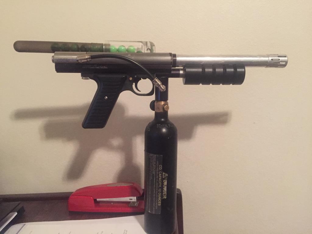

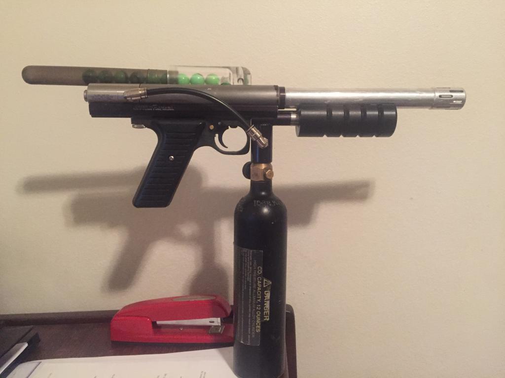

    - STOCK CLASS FEED
    Uses a clear CCI feed block with a 10 round tube jammed into it, sorta like a magazine fed marker. I think it'd look cool with the MM body. The AM body in the photo is just junk that I used as a test run for mounting the feed block. Having the feed block on the right side of the gun using the MM body will keep my line of sight down the left side nice and clear. But I hate the thought of chopping up and drilling holes in a perfectly good MM body... plus I'd have to pay to have it bead blasted to re-finish the SS MM body. It's marred up anyway, so whatevz. It'd be for a noble cause, right?

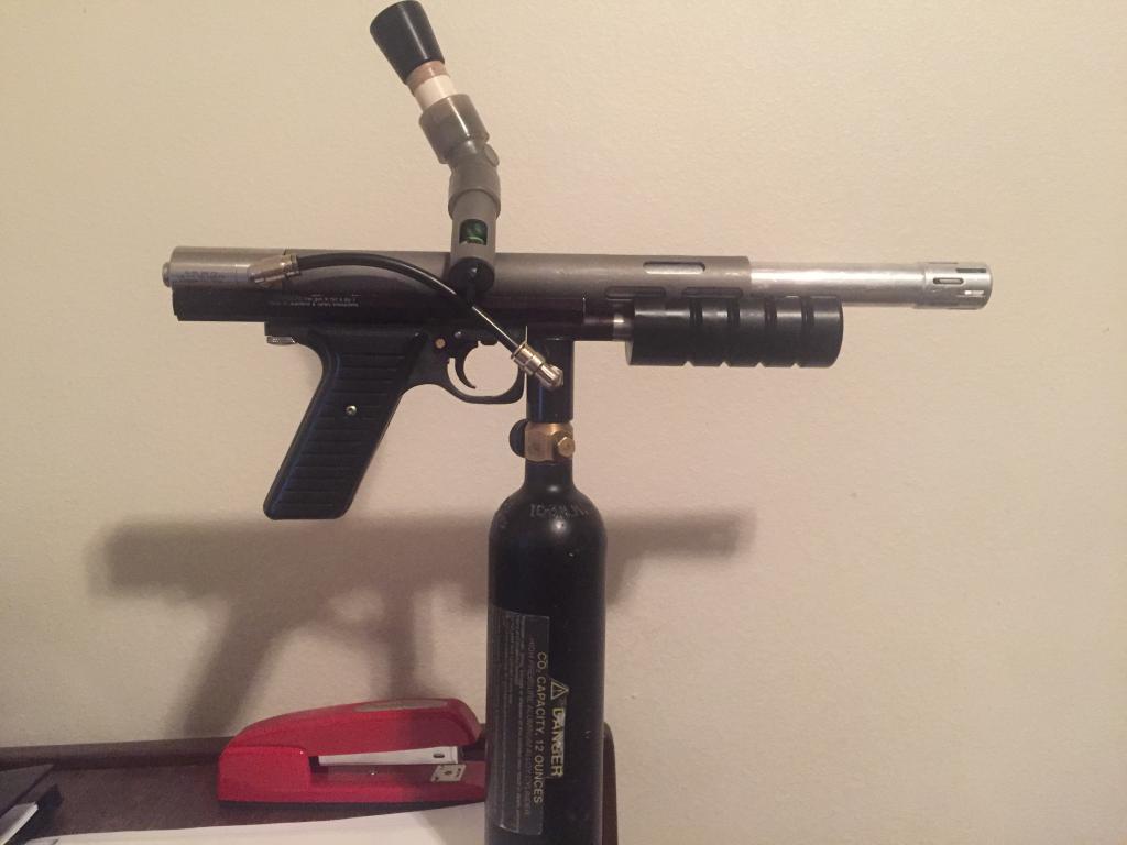

    - STICK FEED
    Would require a couple bucks and a quick trip to Home Depot to do. Picture is a mockup. Perhaps a bit more practical and certainly less destructive/permanent than the horizontal stock class option, but the line of sight won't be as open when aiming down the left side. And it's tall. Almost might as well use the 50 round hopper.

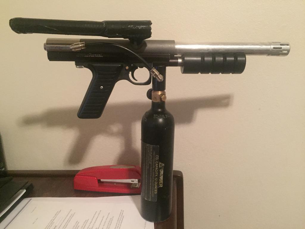

    - EMPIRE SPRING FEED
    Would require the purchase of an Empire spring feed (the black thing in the photo is just a 10 round tube covered in black duct tape as a mockup). I've never used one before, though. Don't know if I'd like it (I imagine that reloading won't be nearly as quick as a stick feed) or whether I could even mount it securely to a 3/4" feed neck. I'd also have to use the less cool looking AM body pictured, which would need to be pump milled, as well.

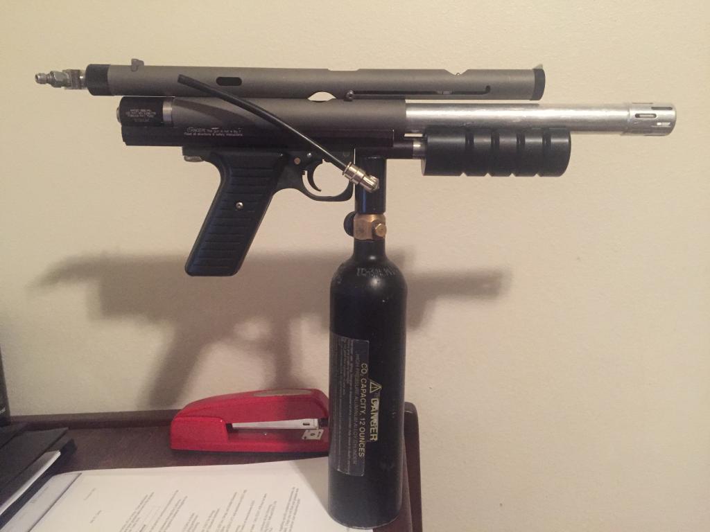

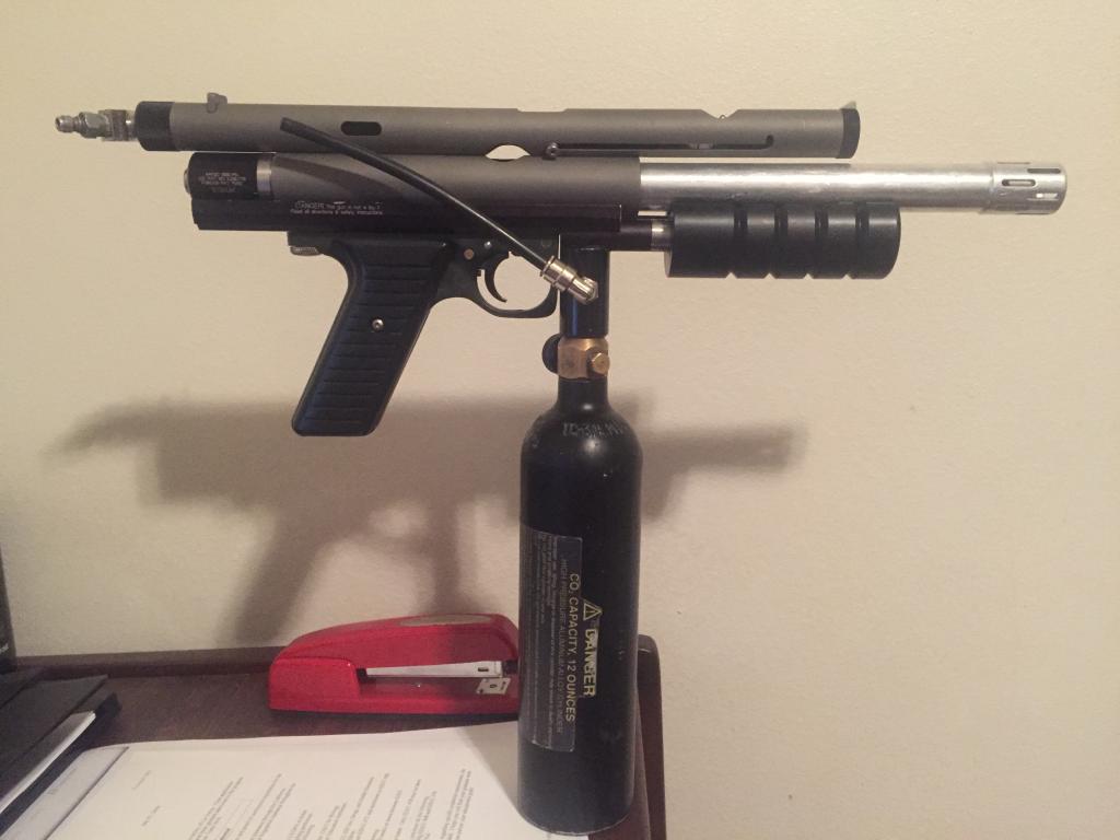

    - SYDARM
    Luckily, the Sydarm body is already pump milled. Plus I have a CA adapter. And it looks damn cool, too. Reloading a Sydarm will always be a pain in the wiener, however. And it only takes 8 rounds at a time instead of 10, so not the most practical option. Will cost the price of a 90 degree 1/4" threaded male to female fitting to do this.

    Bad thing about the Sydarm is it only holds 8, the tubes hold 10.
    Good luck finding an Empire spring feed reasonably priced.

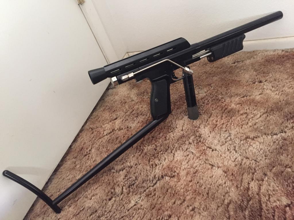

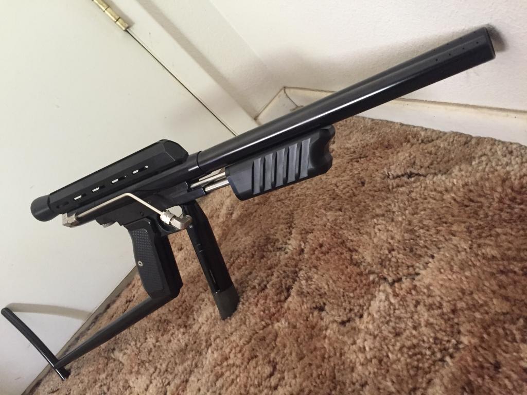

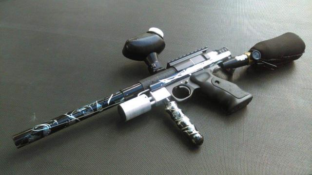

      Im partial to stock class feed. It how my phantom and vsc pumpmag are so its what I'm used to.
      I find my vsc pumpmag is a awesome shooter. Slightly inefficient compared to the phantom. Absolutely gets tons of attention from people.
      This is mine.
        Captian pinky has one for $35. But the question I have is, would it clamp securely onto a 3/4 feedneck? And would the spring feed's slide knob be impeded by the macro line fitting coming out of the valve if I cut down the feedneck so that the spring feed sits close to the body?

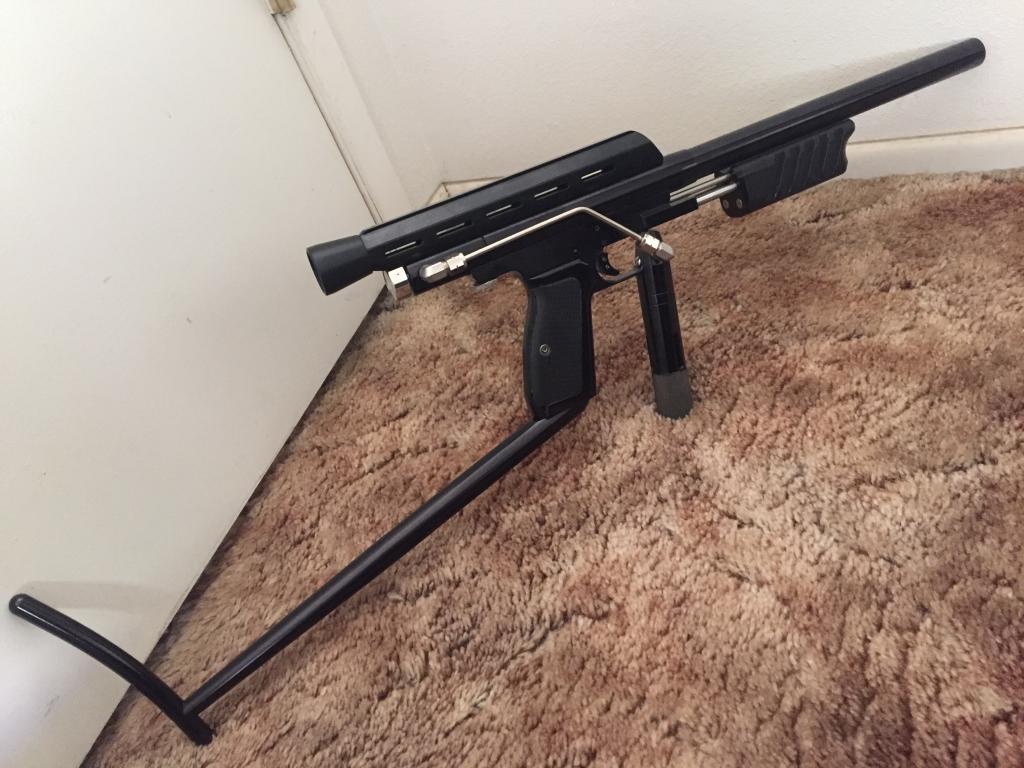

          That's a nice looking gun, but 12 grams through that thing has got to get expensive though, right? Especially with that crown point shorty of yours. I get no better than about 16 good shots out of a 12 gram in my mag. That just doesn't seem worth it to me. If you're getting better efficiency with your mag, please tell me how.
          On the other hand, my Phantom gets 43 good shots per 12 gram, so the difference between my 2 guns is a bit more than "slightly".

            Stock Class!
            The stick feed also gets some serious street cred as well!

                            By the way, regarding the empire spring feed, I can't help but suspect that the reloading process must get old pretty quick, that it might be more trouble than it's worth. Like every 10 shots, ya gotta pull a thing back, then twist another thing 180 degrees, then take out your 10 rd tube and reload, then twist a thing 180 degrees again, then unhook the thing you pulled back before you're finally ready to go. I just imagine myself spending half the time reloading the damn thing. Or am I over thinking it? How bad (or not so bad) is it in practice?

                              I've used the empire spring feed and it sucks, reloading takes forever...you could probably change out a 12 gram and load a 10 round tube into a stick feed in the same amount of time, can't go wrong with a mini winny or a standard 50 round winny
