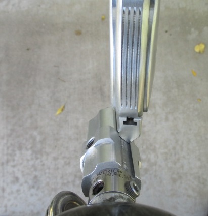

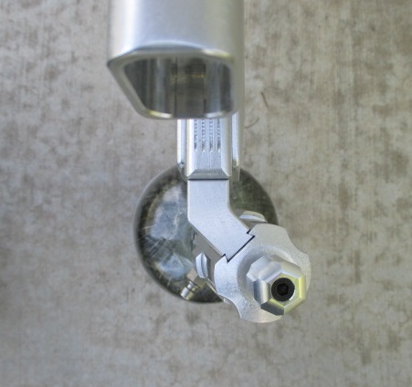

    The Sidekick is a redesigned Off-Set Wedge with a twist. In addition to the tank being angled up at the back, it's also angled sideways. The rear of the tank is now shouldered in the same spot as the butt of a standard rifle stock. Now when you shoulder your marker the height is correct and is in alignment with the center of your vision without having to make corrections in how you aim and hold the marker. It only takes a light grip from your left hand to maintain the markers balance and pressure against your body while completely freeing up your right hand to walk the trigger. This is by far the easiest setup I've found to walk the trigger. It's also extremely easy to switch and shoot off your left shoulder while continuing to fire with your right hand. Aiming around the left side of a bunker only exposes a small profile while maintaining good balance and easy sighting down the marker. I find it feels just as natural shooting off the left shoulder as it does the right.

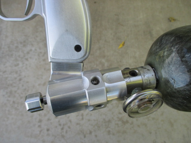

          What about the actual ASA itself ?
          3 air ports ?
          Interesting.
            • 8235
            It's just a Armageddon regulator I customized. I've got a name plate designed to fit into the exposed dovetail behind the Sidkick to clean that up, then it's off to anodizing once I figure out what I want.
            3 air ports ?
            Gauge
            Air fitting
            Burst disk

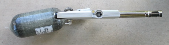

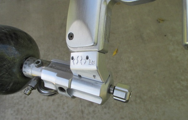

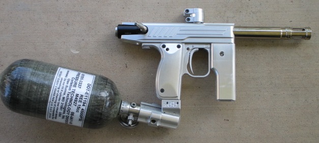

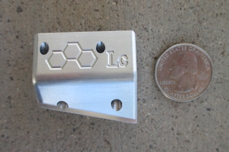

              A few production shots I forgot about, looked much cooler when I took the pictures.
              Completion of step #1 of 6, a five axis machine would have been handy in manufacturing these.

                    I honestly do think that these will fail. The surface area of a dovetail joint connecting the ASA to the mounting is far less than a T-slot, then with them being offset, the center of gravity will put undo pressure upon the top dove tail and have little to no support of the whole. I do not know if you had thought of that, or can not manufacturer the T-slot ASA or even choose to support the plethora of choices for dovetails over the T-slot. I hate to see anyone commit to this and have it fail on them. Been sitting on this, but needed to speak up.
                      • 8235
                      I'll take that bet.

                          I made name plate to finish off the custom 'Geddon reg mounted on a Sidekick. This completes my first marker build for myself, just need's to go to ano.
                            It's obvious that you pay very little attention to the products I make or the mods I've done for years.
                            The reason I didn't make a t-slot version is because they dont sell very well. I can track all my sells back almost 10 years so I have a pretty good grasp on the subject. I never stated I would never make a T-Slot version, if people start asking for them it's an easy addition to the line up. Had anyone expressed interest before production I would have made them.
                            On a side note, I knew up front these would be a tough sell based on the concept alone. I'm simply gambling that once people try them the majority will like them. For me personally I love the setup, it's actually the nicest setup I've ever shouldered in the past 25 years. For me it's a perfect fit and at this point there is nothing I can see to improve on.
