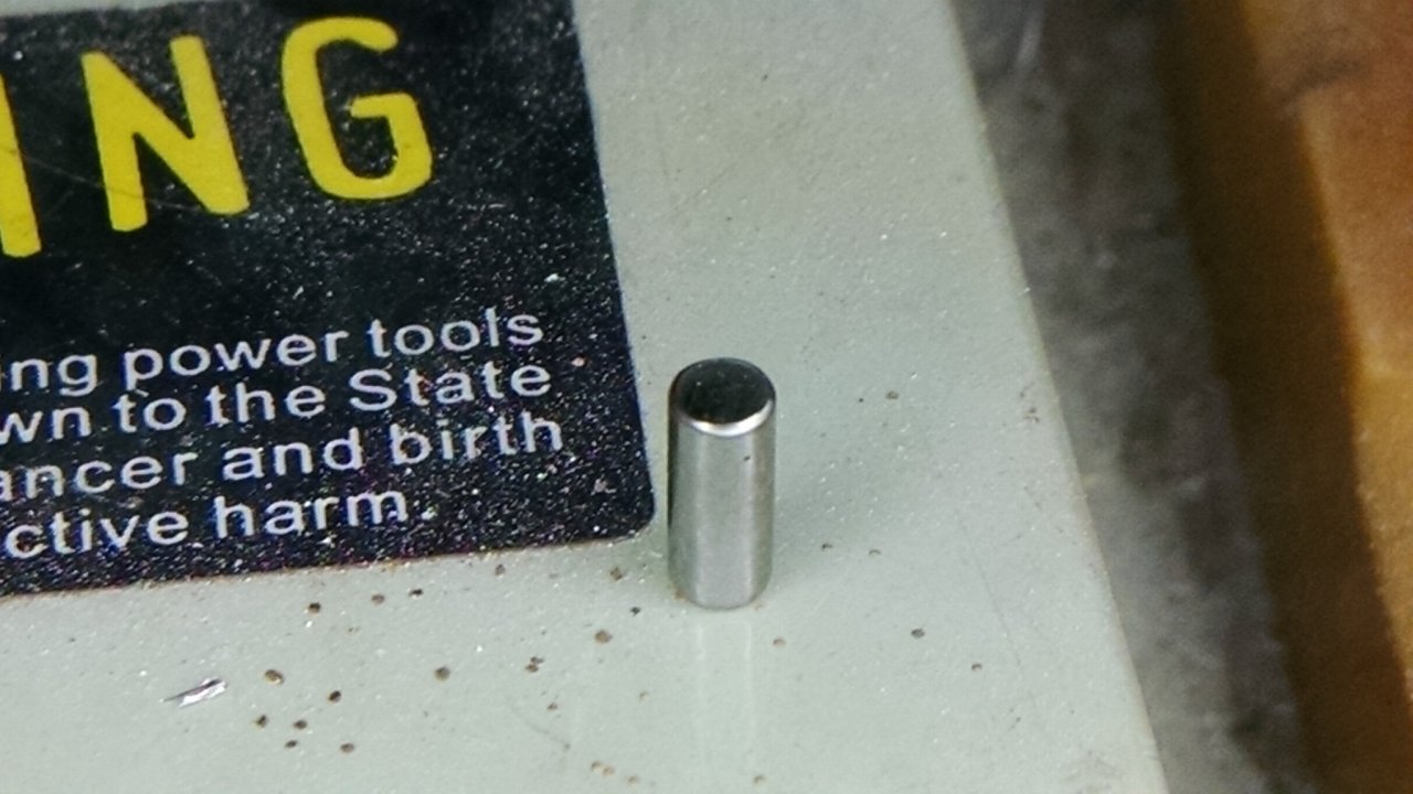

    What if you went to the same trouble to reset the trigger on a ULT that you would on a cranky pneumag? Throw in a magnet and a spring? The automag sear is magnetic steel. If you put a magnet in the bottom of a ULT pin, it will stay attached to the sear. Then, you need to give the sear a small push to return. I presently do that with a small spring stuffed between the back of the intelliframe and the bottom tip of the sear, opposite the clevis. It's a magnet assisted ULT.
    The magnet is a rare earth (40 something, not the newer 50 something) .1" diameter by .1" long. I disassembled the ULT, drilled the bottom, and used red loctite to hold the magnet in place. The pin bottom is slightly magnetic, and it sucks the magnet into the pocket. Residual loctite can keep the pin from setting all the way down in the bottom, so that assembly could use a tweak to make sure the overall pin length doesn't get any longer (and maybe try to make it shorter).
    On a classic, the spring return is a little squishy still. My ULT isn't tuned very tight. I hear shootdown over about 6 bps, which might get better with some ULT washers. However, the idea is to match this up with a light solenoid and an x-valve, and make that sort of setup more reliable.
    Given the o-ring openings between the RT on/off and the ULT, I expect that if I can get ~16 bps out of a classic with an RT on/off (electronic controlled), I should be able to get about ~8 bps out of ULT with electronics. I kind of expect that my fingers are going to limit me to 4 to 6 bps on a regular frame, even if the pull is relatively light. So far, I have had no trouble with sear resetting or the ULT not opening up, even though I have not tuned the ULT to the edge.
    Here's the pin bottom drilled.
    and magnet mounted.
    Here is another version I made, with a .125" dia x .125" long magnet, loctited on the face. The final assembly wasn't as easy as the drilled magnet mount. Since the drilled magnet mount is working (with the smaller magnet), I haven't gone back to this one.

        If it gets gritty, it will wear. I already had polished the sear surface. The magnet is nickel plated. With a little lube on it, light testing hasn't shown any marks. The magnet isn't too strong, just enough to break the o-ring friction. I had considered coating it with something, but I am also curious about the wear. This first part is just to see if the magnet would be enough to hang onto the sear against the friction. Wear is also why I went with the magnet insert; it was easier to replace and after it wears it will get down to the stainless pin sleeve (which probably could have been made the contact surface).
        That pin top is awful skinny to work with, but opposing magnets might work also. What might be nice for a classic is an RT size pin-top with a magnet assisted ULT shaft. Rather than mounting something in the on/off cavity, we could probably design a laser print on/off body (or just top) that would hold ring and/or flat magnets.
        I bought these magnets from K&J magnetics, they have some tiny ring magnets that might work in an on/off body or top.
        This is the one I'm running,
        I can dangle the sear from the ULT pin, which is neat.
