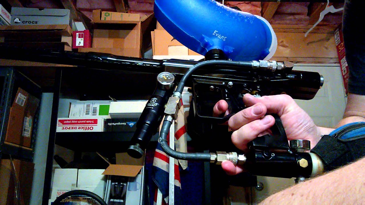

    The pnuematic actuation of the sear makes the trigger pull WAAAAY lighter than the ULT kit.
      • 8248
      Because the trigger pull is short, fast, and light, comparable to an electronic trigger. I can't speak to other pneumags but the T-Rex does not exactly lose the RT with the proper LPR tuning.

        To RT a pneumag, you still need a higher-than-normal output tank and a really good LPR. I have a pneumag that uses a Palmer's fatty LPR, a MacDev reg with 900 psi output, a ULT with lots of shims, and a MAC-43 valve (which has a built-in QEV), and I can get it to RT or not RT. It just depends on LPR tuning.
        But I've built other pneumags with lesser quality parts (like WGP bullet LPRs or Guerrilla tanks), and I can't get them to RT at all.

          Um....because I can?
          For me, it's mostly about the mechanical challenge of it. I like to tinker. It's like playing with Lego blocks, except you then get to go out into the woods and shoot someone with something you've built yourself.
          But honestly, whenever a buddy tries out my pneumag and says that he wants one too, I tell him to just go buy a Mini. Or an Axe or anything else. Because if you don't care about the process and the fun of building it yourself, you might as well save your money and time. You can get a nice used Etek for less than what it costs to build a pneumag, and it will be lighter, smaller, more efficient, etc.
