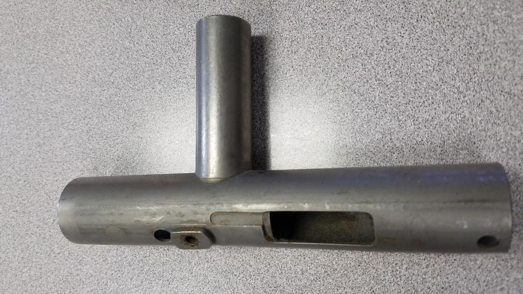

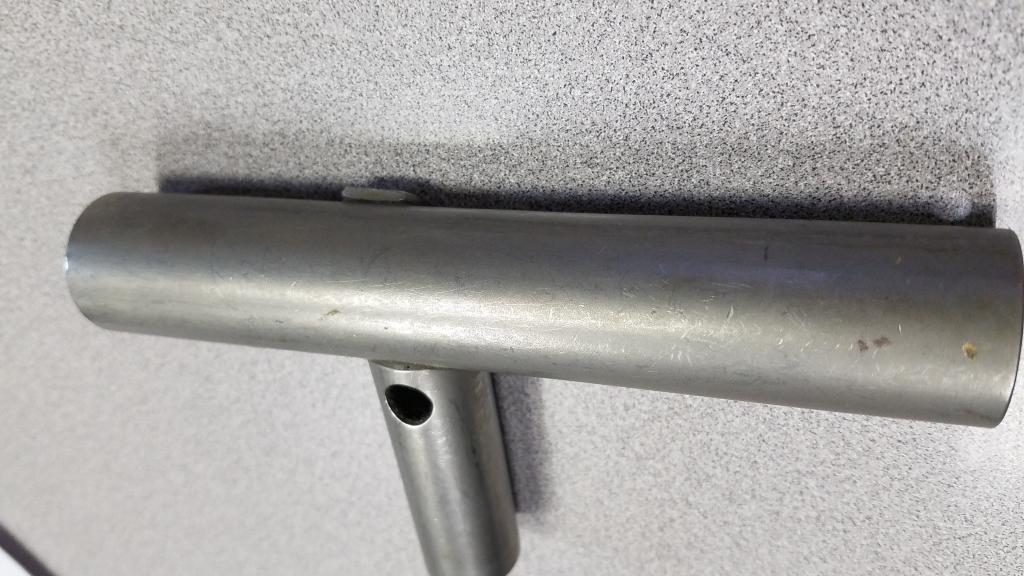

                    Yes, Unicorns do exist. Factory left feed standard body. Pump ready.
                    I don't recall when the pump milling was factory done....my brain doesn't want to remember.
                    These are original factory bodies.

                        Are those just old pictures, Tim, or do you still have some in stock?
