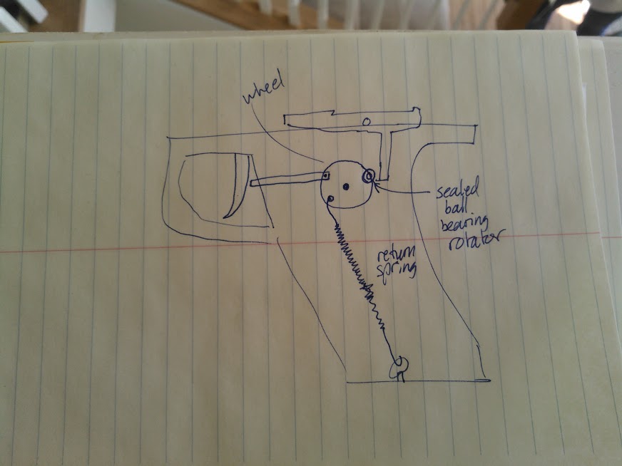

                This is the design I've been mulling over for a while now. (Forgive the simple drawing.) It relies on a rotating wheel that spins on a trigger pin inside the body of the frame. When the trigger is pulled, the wheel rotates clockwise and pushes the ball bearing against the sear arm, firing the marker. (I think a ball bearing would work best here, since it would spin against the sear and not rub and wear down.) Then when the trigger is released, the return spring pulls the wheel counter clockwise, pulling the ball bearing against the sear arm a second time and firing the marker again.

                Obviously, proper placement of everything is really important. Also, I think the bottom left corner of the sear arm would need to be rounded off. Otherwise the ball bearing will jam. But I think the design has promise.
                Also, like I said before, if I redesign the safety, I think I can make the frame switchable between semi and auto-response. If one safety setting stops the wheel right as it engages the sear, then when the return spring pulls back, it won't fire twice.
                  That is a Rube Goldberg. Yes, it mitigates the use of the AR sear, but that kind of mechanism is far from being reliable oreasily implemented.
                  For that, i say prove me wrong. But looking at it, it would not be as easy as it is drawn...

                        I think raw's idea could work as a drop in built off the bracing in an unmodded intelliframe.
                        Getting the geometry right will be tricky, but the idea has potential.
