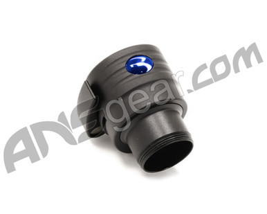

    Never had a Timmy before but I stumbled into one, 2K5 Lasoya.
    Anyone have any idea what the feedneck threads are ?

        As far as I'm aware, most 2k5 Timmys use what is referred to as 2k2/Alias threads.
        Doesn't look like Simon has an FLE feedneck that is made for these markers.
          Nope, thought i saw an adapter for it but i am wrong.
            The 2k5s are the same as some cockers like the Karni.. at least I think it is.

                  From Garret at Field One:
                  The 2k5 Lasoya should have cocker threads for the feedneck.
                  There maybe a slight chance it came with 2k2 intimidator threads.
                  Cocker threads are a wide, whereas 2k2 is skinny and basically straight tube. Do you have pictures?
                  Sent him a link to pics.

                      So there are 2 different versions of the feednecks for that Intimidator level (Alias). One is a wide feedneck and the other is thinner.
                        • 8365
                        That looks like a 2k2/alias threaded feedneck.

                          Those are called "2K2" threads. Also, called "Alias" but they were introduced on the 2K2 timmy.
                          I've owned my alias since it was newly released in 2005.. and the best feedneck I've ever had on it was the Bob Long Leverlock, it was a 2 piece, not unlike the ID brand necks. They're slim pickens nowadays but you may want to keep an eye on Dirty Works as he's got all the old inventory (http://www.dirtyworks.com/blast-lega...-complete.html).
                          Other than that, a CCM neck, or a Hybrid are also decent options.
