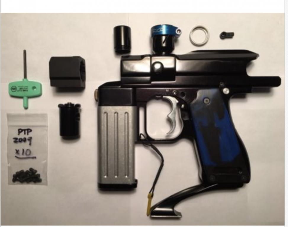

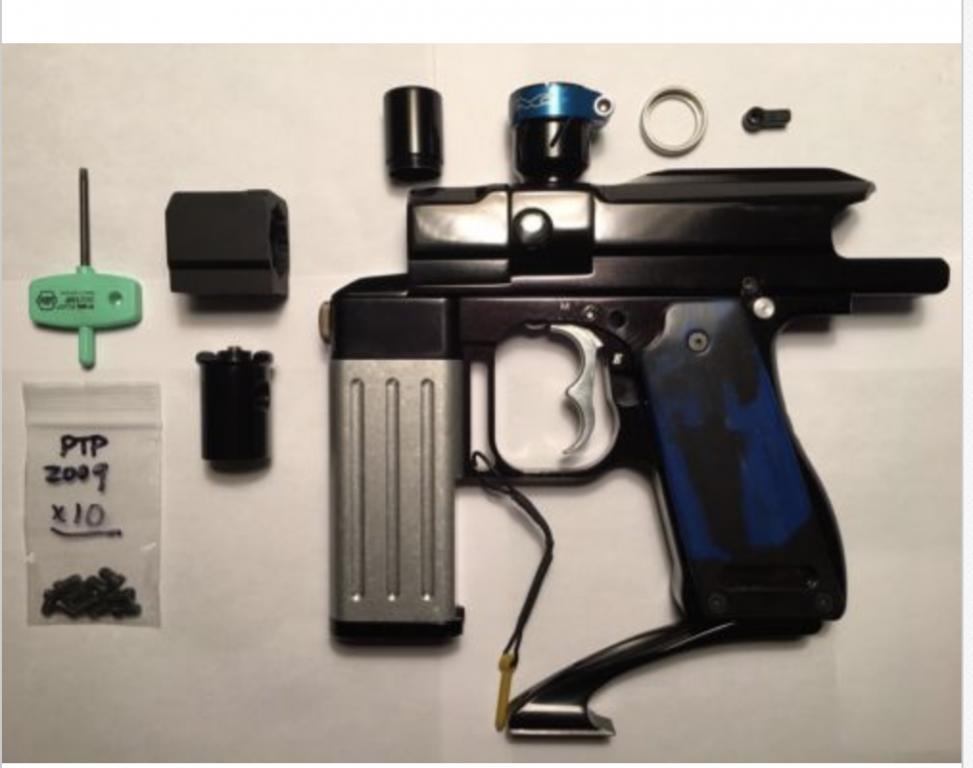

    Purely out of curiosity and naivety (and maybe more money than sense), I bought a 2k9 body that Im sure everyone saw on eBay for a stupid amount of money. I would really like to pick around with this think and get it to work. Did anyone have any luck with the 2k9 body? Or were they all bunk? I really would like to find a way to make it work, it would be unique. I figure I may have to fire up the Old Bridgeport at work (after hours of course) to get this thing working.
    Please advise. Tell me why I am a fool or whatever. I am having trouble finding info on this thing. If I can't get it to work I will just go another route.
    -Chris

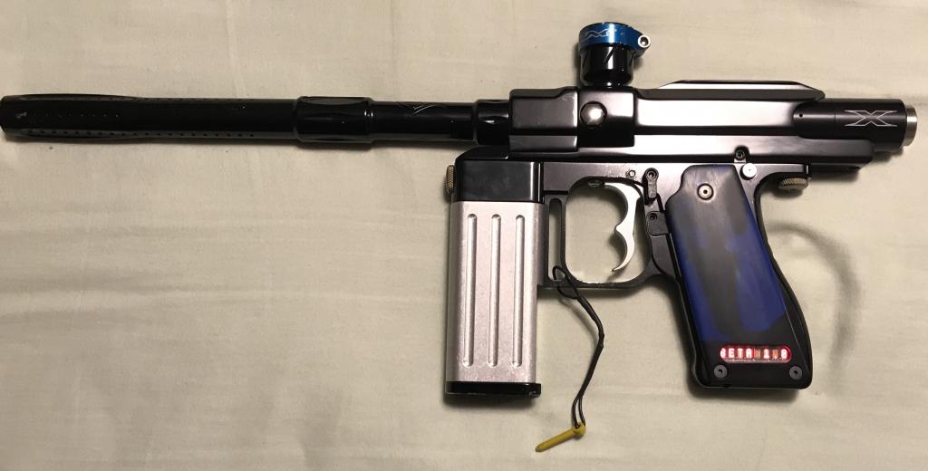

          Looks good, I didn't have a chance to put paint through it yet.
          Thanks to Tuna for getting it put together for me.

                            No. There is a problem...a very BIG problem. Obviously the body was milled wrong. They sent a steel ring insert that is supposed to be pressed in like all the other crappy bodies they made. The problem is that it doesnt fit. It is too small. I fixed this issue by using a steel ring from an Xmag. It drops right in too, but fits way better than the one they supply. Remember when you take this gun apart that the steel ring will come out with the valve. The ring must be dropped in before the bolt and spring. This should stop any unnecessary wear on the body. Works great. How long it will last is anyones guess. I have another one here that the guy tells me that he has been running L10 on it for years. I cant even get the L10 bolt to drop in the body. Its all mashed up in there. Explain that one to me please. These are some of the reasons that AGD would not work on guns with aftermarket parts. Most of the time they didnt work. I dont blame them either.
