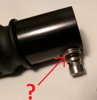

              Then numbskull me decides to throw them on. In my excitement, I overtightened the one on my AGD ASA... and sheared off the threads from the rest of the nubbin. Now I have no idea how to get these threads out of the ASA without damaging it.

                Sounds fishy, you should have stripped the hex key long before snapping the bolt.

                    Can you post a picture of the individual parts?
                      • 8354
                      Azodin:
                      CCM:
                        • 8216
                        Did it break here?
Name:	broke where.JPG
                        I'm curious to see the broke piece.

                            Yeah, it broke right there. Sheared under the o-ring. I'll try to take a picture in a day or two. The wall under the o-ring is pretty thin.
                              Go down to the autoparts store, whether AutoZone, Advanced Auto, O'Reilly, whatever. Take that piece with you for a visual & for the size you may need. Ask for an EZ-out. If you are lucky, you could borrow one, unlucky you have to by them. Get a bottle of PB-Blaster, for some lube.
                              If you are lucky, it should come right out, if not. You may get pieces and chips coming out. I would advise getting a tap for the ASA threads to chase them if they are damaged.
