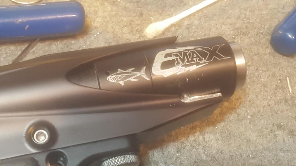

        Ugh.. I HAD TO DO THIS TO THE ZLOCK "AREA" (IT'S NOT A GROOVE) TO MAKE THE VALVES FIT RIGHT. I WANT TO SMASH SOMEONE IN THE FACE WITH AN AX RIGHT NOW.
            Dammitman! I probably would have opted to grind the pin off.

              Oh I read it again ef that. Is that a machining issue or ..... can you explain the issue for the people not in the know.?
                Im not grinding anything off of a Dust Black Tuna Emax valve. None of my valves fit.. I was hoping this was a fluke or something.
                  I already know of course
                  Well, somebody do tell. Looks like the z lock step was missed in the machining process?
                  As for grinding off valve pins, goodness, no. They are removable.
                    #24
                    Looks like its too late for that now.....

                        Z. Locks are barbed. They don't come out

                          #27
                          Ah.
                          Did not know that. The old roll pins in the classics come out and go back very easily. Figured the newer style did the same, but in a different way.

                            Was it lacking a channel or was the alignment off?
                            It's hard to tell in the picture if there's room, but another option would have been just to machine a new groove. (Or fix it, whatever the case.)
                            A few minutes on a mill and you can clean that up, then do a black oxide touch-up to hide the raw aluminum. >> https://www.birchwoodcasey.com/Refin...-Touch-Up.aspx

                              were all of them like this ?? ,, haven't seem anyone else post about it

                                #30
                                Here is a picture of mine. I didn't have any trouble with mine, but it appears you didn't even have a channel to begin with.
