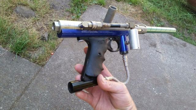

    Getting back into paintball and want to build this old minimag. Anyone have an idea what is on the body of this minimag? The hose on the side that goes into the chamber? If you know what it is then can you tell me what it does?

    Looks like some sort of a home made expansion chamber for CO2 use.
      ^^^^^^^^^^^^^^^^^^^ what he said.

        If you're planning to use HPA, then you can remove that part and just run an air line from the ASA to the valve.
