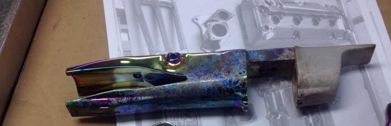

                          But every now and then you are lucky enough to get one that turns out just right.

                            • 8365
                            This is all right for a wall hanger, or a speedball gun, but you might as well wear an orange vest playing woodsball you're going to stick out so bad with such a shiny marker....

                              It's definitely a speedball gun as I have others more suited for woods ball. A Luxe and the forest usually don't mix well by design. But honestly lately mostly all of my guns are wall hangers as I only make it home 4 days a month.
