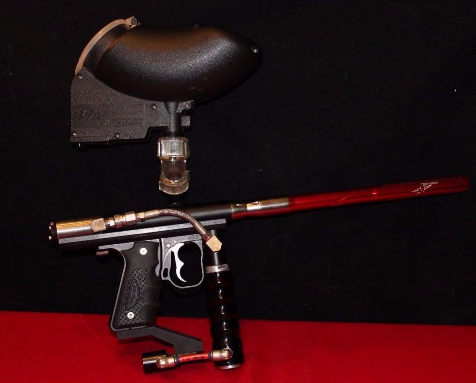

    Friends have taken me paintballing a few times and I've taken a liking to it. A field by me is free admission if I bring my own gear(so long as I buy paint), so I decided to spend some money on a marker. Instead of buying a Tippmann like everyone on the internet told me to do(and because of my obsession with being different), I did a bit of reading and research into the history... and I bought an automag! It just came in the mail today, but I have no idea what I've got here. I've done a fair bit of research, but I don't really know what I'm doing at all.

    Here are some photos: https://imgur.com/a/GWOdq
    Based on the ACI expansion chamber, I realized that this gun was adapted to run on CO2, but I can't really tell any more about it until I take it apart tomorrow after testing for leaks. If anyone has any advice on doing that, by the way, please share. I also read that mags love oil, but I'm not exactly sure where to put the oil. The articles all pointed towards the ASA, but I'm not exactly sure where that is, since there's the expansion chamber...
    congratulations and welcome to the addiction. put 4 or 5 drops of oil in where the tank screws in, remove the barrel and air up and fire the marker several times. this will completely oil the valve. going forward you can use less oil but always remove the barrel so you don't oil it and cause your paint to shoot all over the place. what you have is a hopper right, power feed classic mag with an intelliframe and aci expansion chamber with a J&J barrel and a revolution hopper. all good parts. i would recommend getting a CP on/off asa(the part the tank screws into) and replacing the expansion chamber with either a lighter gas thru foregrip or a non gas thru and changing your set up to run macroline from the asa to the valve.
      also make sure you have the parabolic power feed plug.
        your air tank will need to be 800 to 850 psi output. you can air it up and if it doesn't leak your good but most of us will take a new to us valve apart and check or replace all the o rings when we first get it. you can get rebuild kits from AGD or Tuna.

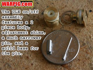

            Ok, so I think I may have done something really wrong. When I disassembled the valve, a pill shaped metal rod (rounded ends) fell out of what I thought was the valve assembly. I put it back in, but when I reseated the bolt and the bolt spring, the bolt pushed the small metal pill into the valve itself. It's now clinking around in there and I have no idea how to get it out.

            The pill was the same as the thing on the left side of the quarter.

              I believe that the "pill" shaped item is the sear pin. That slides into the sear, which allows the sear to rock back and forth. I could be wrong, but 99% sure here. I believe that as you took the gun apart, the sear assembly fell out and you did not notice it, as the on/off came out.

                You are 100% correct. I managed to get it out and reassembled the gun without issue. Upon disassembly however I noticed some other weird stuff. More pics tomorrow.
