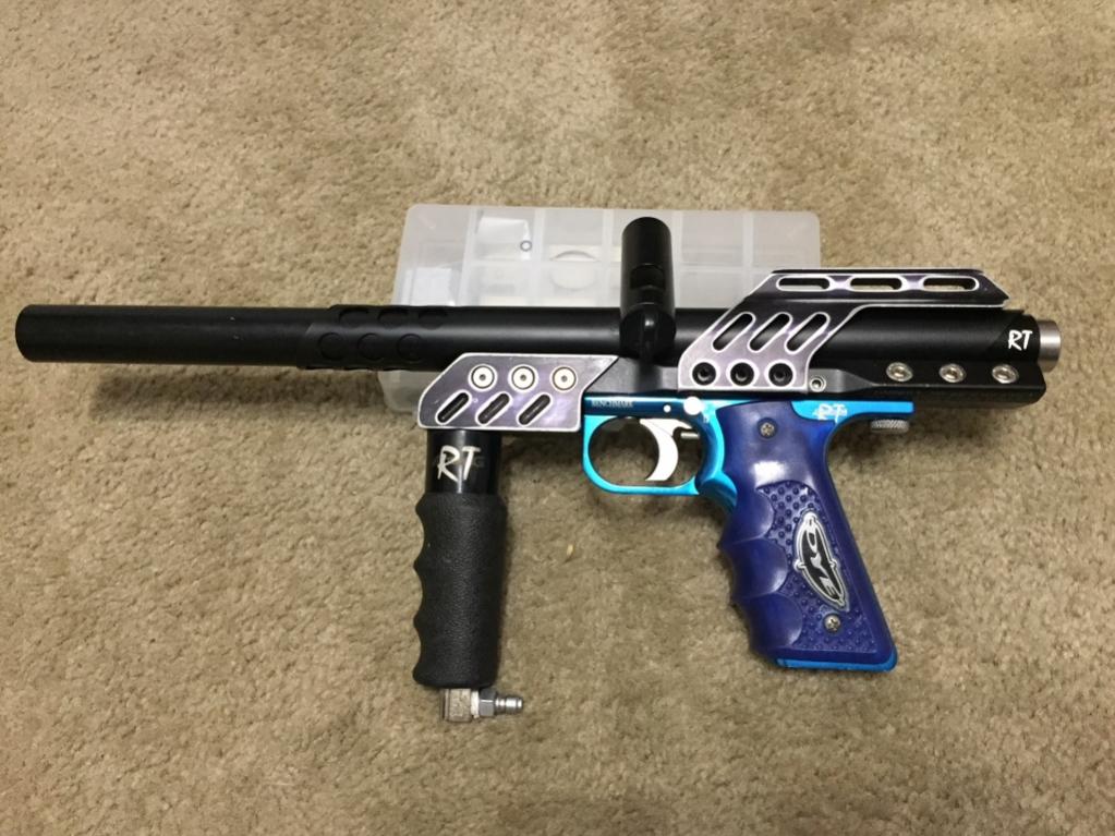

    So is everything I've read about the freak XL just marketing hype or does it actually make a difference over the normal freak system? The only real reason it interests me at all is because of my favorite barrel for my classic RT mag. Not sure who actually made it or what its called even but I love the look of it on the RT. I'm pretty sure the longer inserts would be just about a perfect match for the barrel length too. I believe the barrel is more than thick enough to support freak boring as well, if anyone even does that anymore. Be nice to have a unique tip on the barrel to add a bit more character to it.

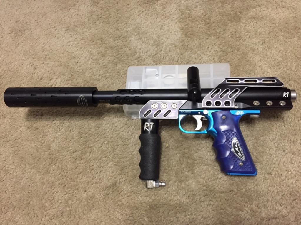

    Though I have to admit, I like the compression barrel on the RT too... but I won't ever get that freaked.
Name:	rtmag compress.jpg
    I really need to find a new frame for that.. gotta get rid of that blue.

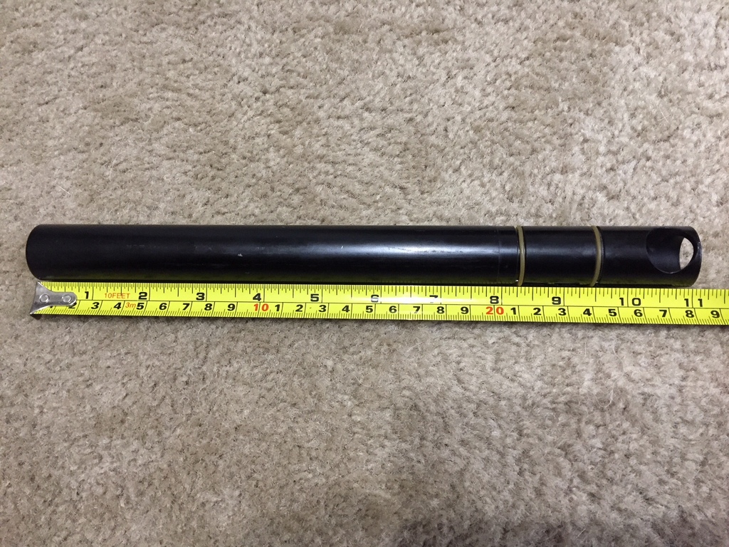

                Anyone know of someone that still does freak boring? Someone linked me to a facebook group that does freak boring, but they bore from the back end of the barrel. I'm wanting to get a twistlock bored for the freak xl, preferably with the end threaded for a nice tip (old freak threaded) to be installed. The image is the barrel I want done, the freak xl should fit rather nicely.. may lose a half inch of the barrel, but the tip would make that up plus some.

                  You would have to talk to him directly as twistlocks are more difficult and how you want it is not the norm, i don't think. I am sure he has facebook but also on MCB

                    Not sure a twistlock would work as the insert would not be able to seat against the breach since it has to be forward of the hole the ball drops into.
                    I think the XL is long overdue, never been a huge fan of the freak since you're only sizing 1/2 the barrel and the front half is too large to do anything. If you already have a set it's probably still not worth the upgrade but definitely the way to go if just purchasing one. If I didn't hate Gog/GI/Smart Parts I'd already own one.

                      But the easiest way would be get a twist lock to cocker thread Automag barrel adapter.

                        Already have a twist lock adapter. I just reeaaally like the look of that unported barrel on the classic RT. But it's a really large bore barrel, so I was hoping to find someone that would bore/tip it. But it doesn't look like that is possible.
