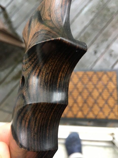

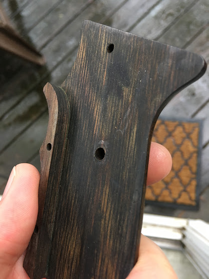

What kind of wood was used for wooden grips?
Okay....more pictures, as requested.
You're definitely right about the wood being laminated. It's pretty obvious from the front.
That makes this whole project much more complicated, though. I only wanted to know the kind of wood so I could match it, but if I have to laminate stuff....that sounds like more trouble than it's worth.
I'm also thinking about the blocks of rosewood that I've got sitting around leftover from a box I made last year. There's enough there for a set of matching grips and pump handle. That honestly might be easier. Or at least within my comfort zone.Comment

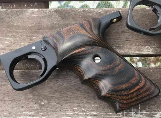

Here are few pictures of stained grips I made.

Late to the party, I know.
But as a career wood worker I might be able to add some things.
First off, those look like Smart Parts grips. Made from laminated wood using a polycarbonate resin much like the brand Diamondwood, not just "glued" together.
Secondly, the layers are dyed, not stained ~ (there is a difference) ~ and the dye process is before the lamination. Often layering two or more different colors to achieve a specific look.
Most laminates like that use domestic closed-pore woods like beech, walnut or one of the maple varieties.CT Co-ordinator, Paintball MarshalsComment
