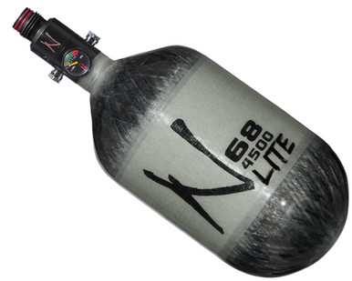

                              ANSgear is the worlds largest online paintball store. Huge selection of Paintball Guns, Tanks, Masks, Loaders, Harnesses, Barrels and more. Fast & Free shipping will keep you up to date with all of the best paintball gear.
                              Go with this one. Ninja is a great company
