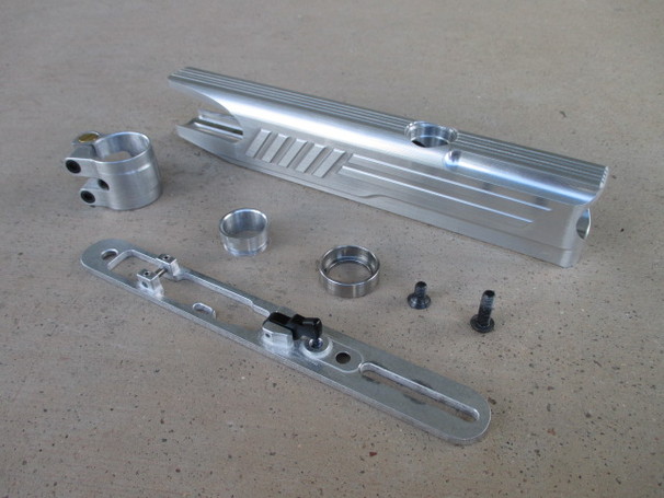

              I'm working on new slug bodies, and I want to add a wire clip to hold the stainless spring cups in place. Mine will be a larger diameter than the AGD ones but the same wire size. Unfortunately I have never been able to source the AGD ones, I believe they are a proprietary part so I'll probably end up having to have them made.

                      • 8215
                      Slug Body and rail

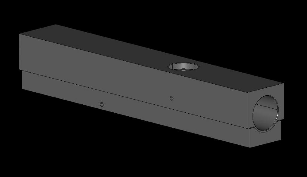

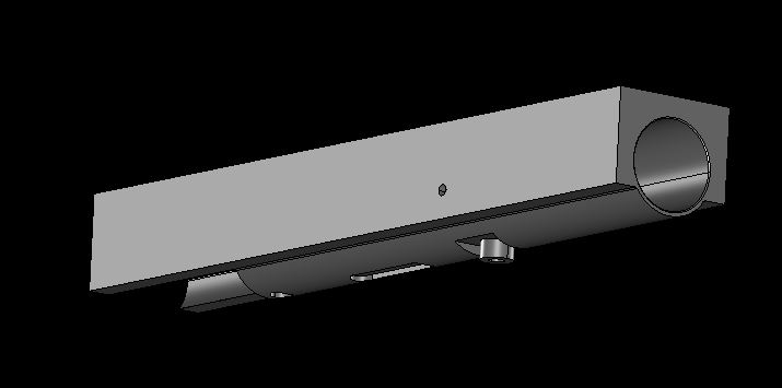

                        Just curious, if you (Luke) or anyone knows, with aftermarket bodies/ule bodies was there any reason why the detent was never placed under the body and use like a small detent like a spyder or tippmann style detent?
                          • 8215
                          With aftermarket bodies/ule bodies was there any reason why the detent was never placed under the body and use like a small detent like a spyder or tippmann style detent?
                          Yes there is a reason but I did pull it off with the Unibody I designed. The problem is the Detent needs to go where the front grip frame screw lives. I solved the problem by going to two front screws, one to attach the rail to the body and one to hold the grip frame to the rail.
