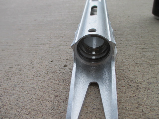

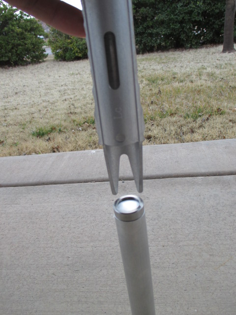

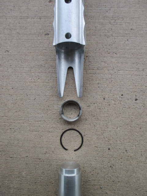

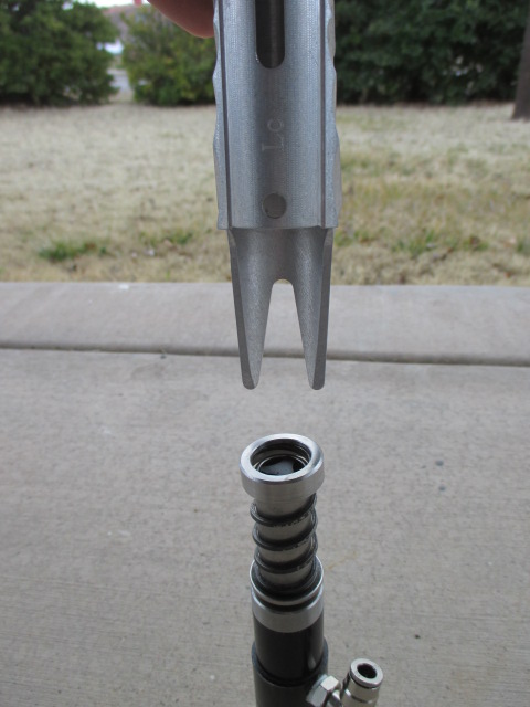

            The SS spring cup can be a hassle to install and remove if you just drop it in and try to move it into place. However there is a trick that makes it easy. I made an instillation tool to install and remove the cup but you can use your AGD valve for the same purpose. The tool I made also installs the clip (which wont work with the AGD valve) but a simple 1" dowel rod could be used in place of the valve.
            First I install the ss cup into the end of the body then get the clip started, make sure the open side of the clip faces the bottom so you have easy access it through the sear slot for removal.
            Once the parts are in place I hold the body vertical then slid the clip and cup into place. There is a distinctive 'click' when its installed.
Name:	ss cup install 3.JPG
Name:	ss cup install 4.JPG
            To remove, just use a pick to get one end of the clip out of the groove and work the pick in a circular motion under the bottom edge until it's free (Just like the AGD round clip). Work it out of the body, then install the AGD valve, hold the body up vertical, lower the valve and the ss cup will slide out.
            Hope that makes sense. There is a small learning curve but it's real simple if you follow the procedure. If you need more info please let me know.
Name:	ss cup install 1.JPG
Name:	ss cup install 2.JPG
            Without the installition tool or 1" dowell pin to instal the clip follow instructions to install the SS cup into the bottom of the cavity, then just work the clip into place as you would on the AGD version, it takes a little longer but is doable.
