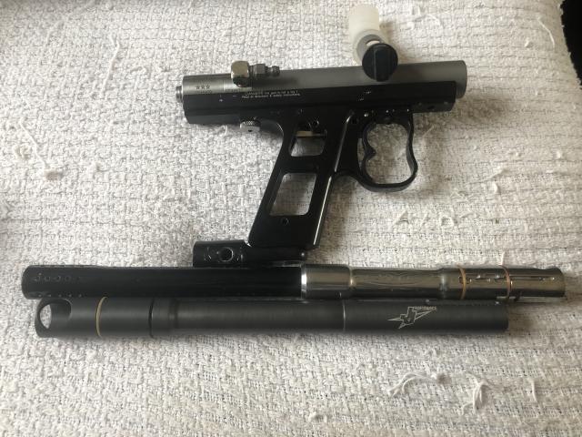

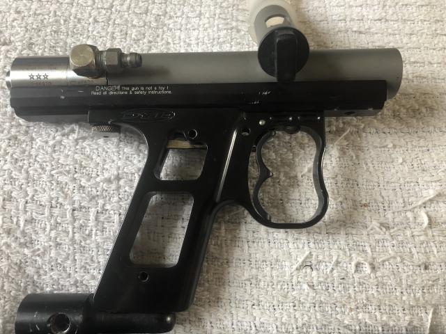

    Pics for reference

      Some rubber grips or panels for the trigger frame would a start. A parts kit just incase you need to replace O-rings, bolt spring or plastic nubbin. Replace those metal nubbins for plastic ones. I think 2 come in the parts kit. You also might want want to hit up YouTube, you should still be able to find the old AGD videos concerning with maintenance and basic repairs for your automag. Aside from that, welcome to the fold and hope you have a great time with your automag.

        It actually has a set of what look to be modded DYE rubbers, I just left them off for the pics (screws missing). I will look into the rest though. Thanks!

          What Gundam V said. A good o-ring rebuild and new plastic detents for the barrels is all you "need". Spend enough time here though and any alternate part imaginable will spark your interest. Mag parts are not getting cheaper though! (mainly because they last forever)

                              You have two great barrels there, use em. They may not be the best with small paint and a force fed hopper. Forget the cocker adapters, if you go that route, go ULE.
                              Level 10 bolt if no one has mentioned it yet.
                              Lastly, that trigger. I find the triggers without a flat back tend to have inconsistent pulls and sometimes take higher force than needed. Get an AGD, Lukes, Nummech or Tunaman trigger. (personal opinion)
