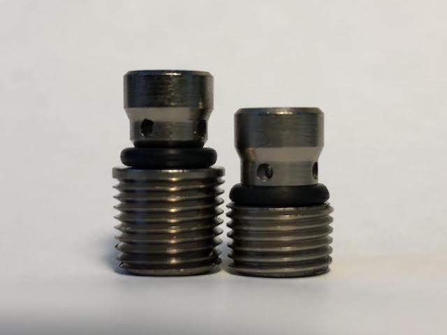

      I'm eyeing the CCM fittings for a few of my builds. I didn't realize the stock posts aren't sized well for automags. Can you share what's different between the two lengths?

        Quoted from my thread on this a couple of years ago:
        Owing to the relatively shallow depth of the air fitting inlet, AGD threading on the valves runs a little small. Added to this is the fact that CCM builds their fittings to their own markers, which run a slightly larger spec.
        Stacked up, these tolerance differences mean that newer CCM fittings typically will only go about two turns into mag valves, which is not ideal for strength, especially given the input pressures we like to run. Probably most folk don't even notice this, but it is something to consider if safety is an issue for you.
        Their older fittings had longer posts, which worked well in this application and allowed more turns into the valve, but of course, these are no longer available new.
        Basically the longer posts allow you to run the fitting deeper into the valve. I've got an original set of this new run, and love them.
          I believe it has more to do with the fact that most people are using them for the nummech frames as they are longer and can stretch high enough to line up with the short fittings at the valve.
              Longer AGD post on left. Standard on right.
