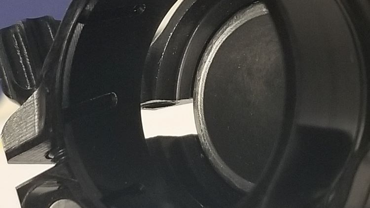

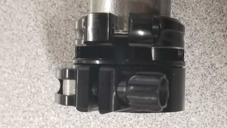

      • Sandman
        AGD
        • Feb 2011
        • 405
        It does slide on for sure. It's a snug fit on the stainless but I'll assume that it will slide off with any significant jolt when a hopper is in place.
        It would greatly benefit from a roughing up the stainless surface where that 3/16 of an inch grabs. Then it might hold. Certainly worth a full test if you have a vert body collecting dust.
        AGD is in the house!
        www.airgundesigns.com

          Thanks Sandman I appreciate the pics and insight. I am coming into an Emag with a high rise vert feed. I am looking into solutions for low rise setup until I can obtain a ULE body or a no rise stainless body.
