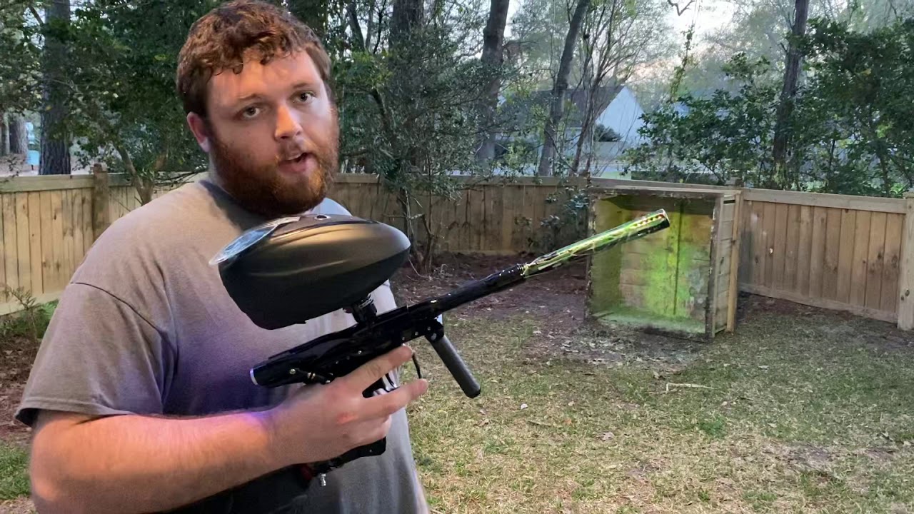

    Modded an inception on/off to work with my nummech frame. I have been wanting this to happen probably since i tested the frames. ha. I had just been swamped with work and always had something else to work on.

      ya, i actually love the inception ones. i don't have to think about it. super easy to take apart and they function like they should.
      I hate the PE ones because they are significantly harder to turn on even at 800psi output.
      The inception one was designed to be slammed like seating a magazine.

            Thanks, I would say for the average person to do at home it would be pretty difficult.
            I am planning to offer it as a service/possibly selling modded ones if there is a demand for it. Still trying to figure out what im going to do about the front plug. I may have to get a tap to chase the threads.

                    The front air port is the same as a normal air fitting, so unless Simon is using a different macro fitting, a 1/8th npt set screw will work
                      That is what i am currently using, but if you look at the pictures you see that it still sticks out a significant amount.

                          The problem isn't the bottom, its the shape of the plug and or hole. npt threads are tappered and intended to actually seal against themselves. so it either needs to be straight tapped or something creative.

                              Hah. For some reason I always thought that the NPT thread just has a slightly different pitch between female/male to cause it seal. Now reading what the abbreviation actually stands for, it makes much more sense.
                              So.. you’d need to ground down and re
                              thread for that to work.
                              NPT threads are tapered. You can straight taps too, I have a 3/8 x 18 straight tap as well as the NPT tap.
