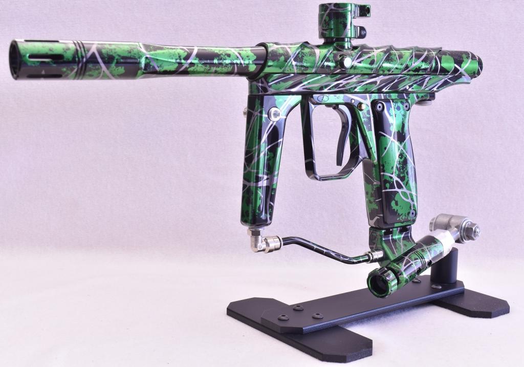

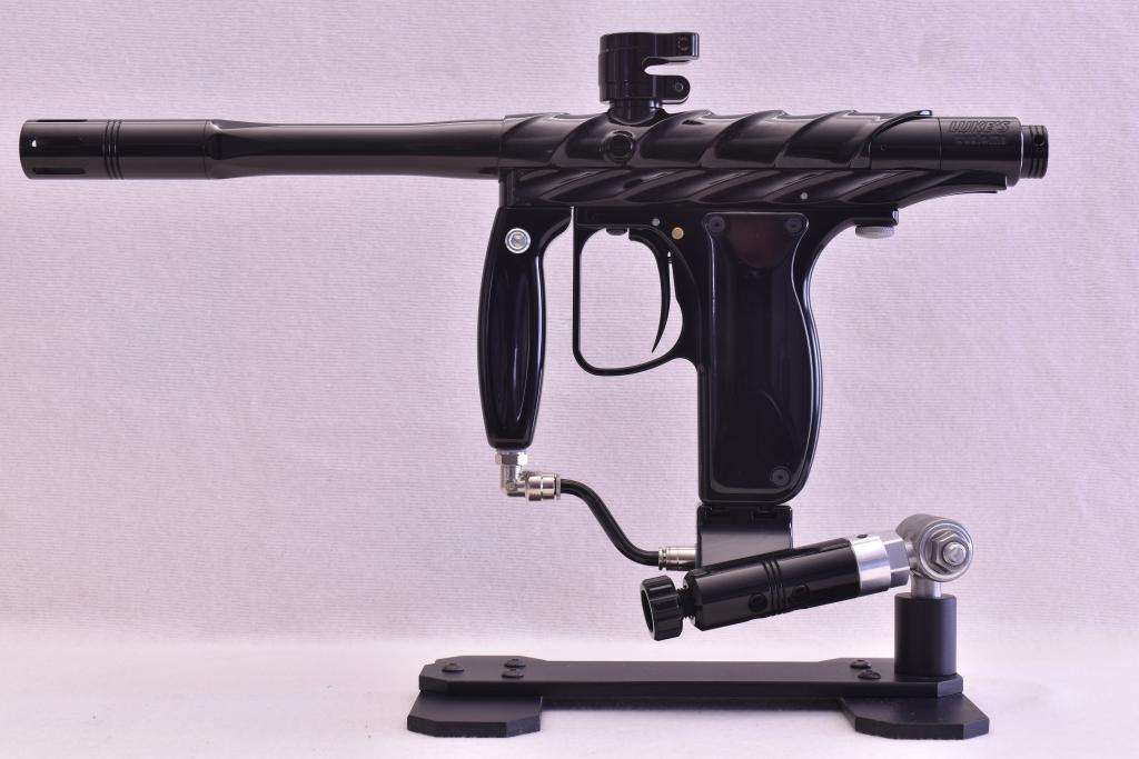

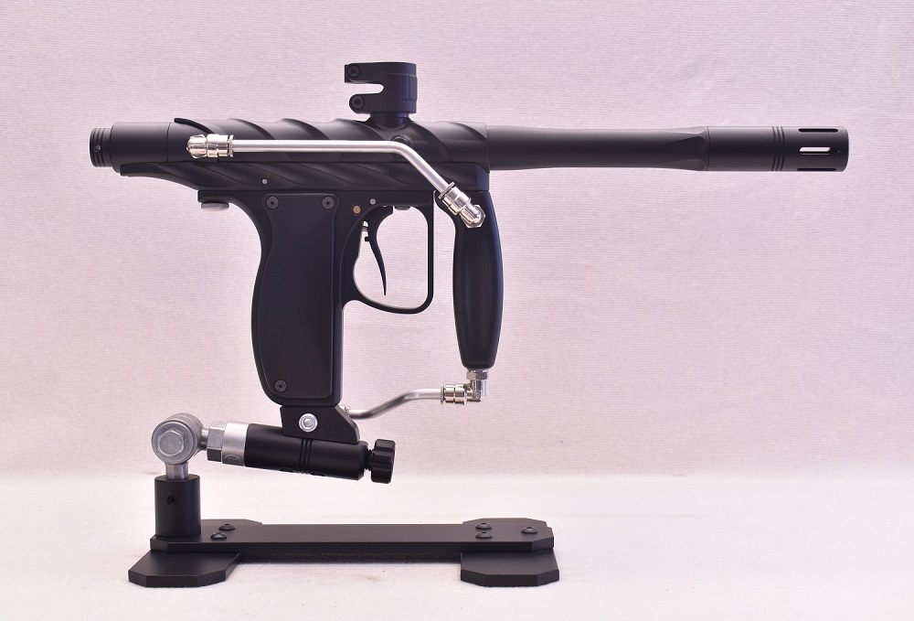

          Gundam_V's Z grip Wave build with the Lc P1 marker stand
Name:	Hilmar Pauls Blue and Black Wash Z grip Wave 9 Build.jpg
            [ATTACH=CONFIG]103472[/ATTACH]
            What a beaut!!

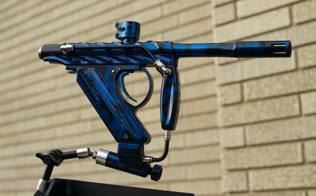

                        #116

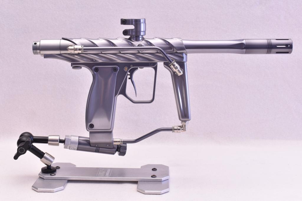

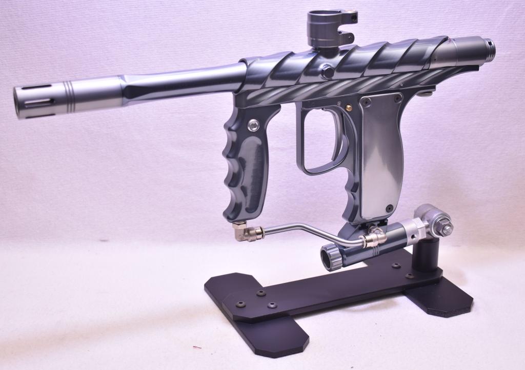

                        Silver Wave
Name:	Silver Wave a.jpg
Name:	Silver Wave b.jpg
Name:	Silver Wave d.jpg

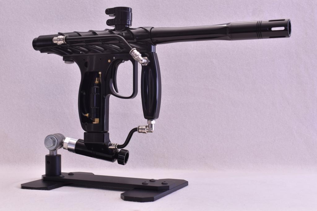

                          • 8235

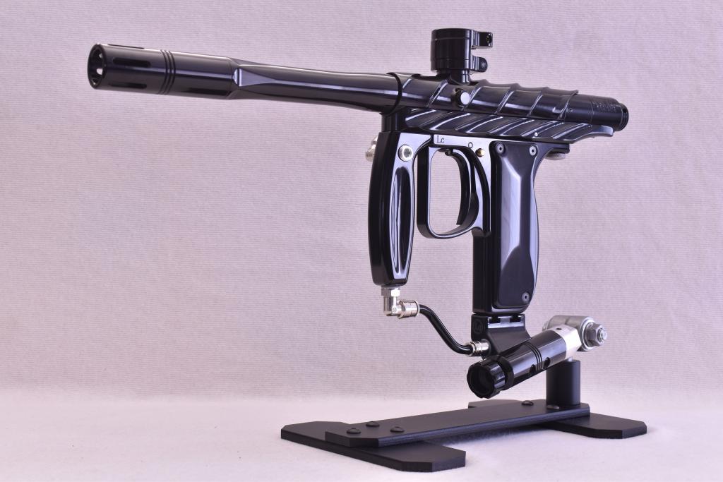

                          #117

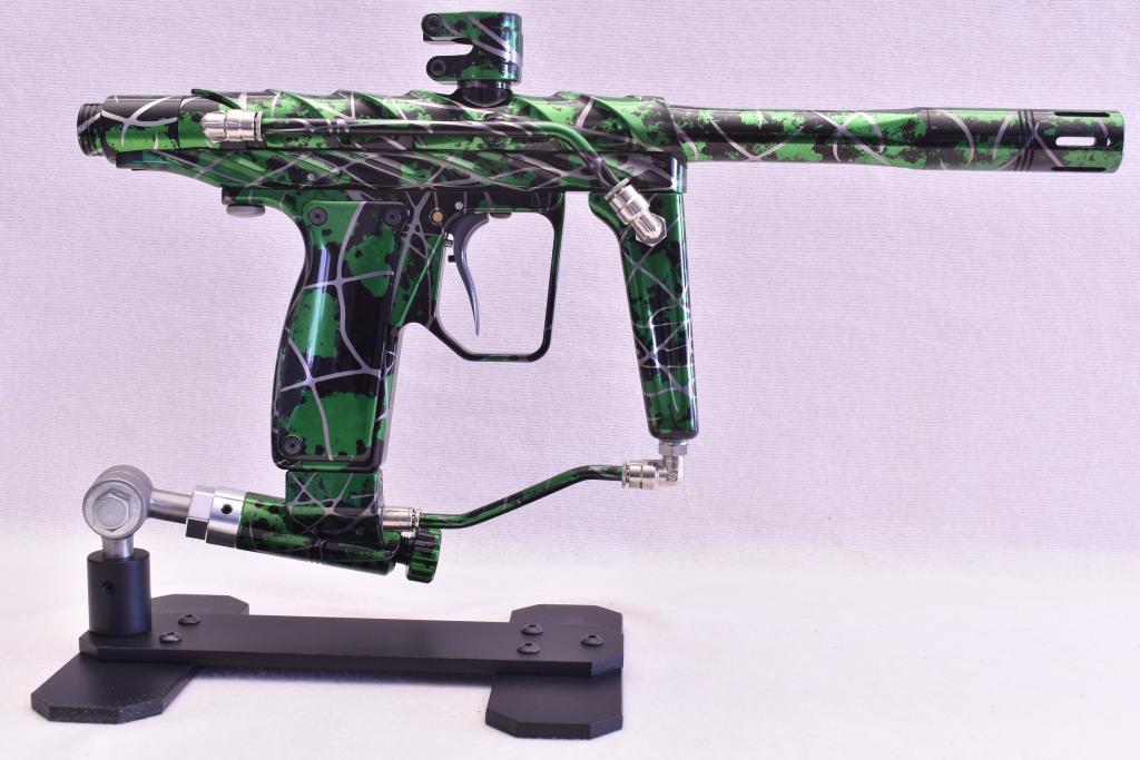

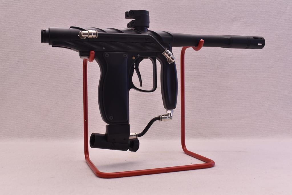

                          Wave 8
                          MP90 with Ultra Blade
                          T-rex and P90 LPR
                          Gas Thru Sidekick ASA
                          LcX Valve
Name:	Black Wave 8 d.jpg
Name:	Black Wave 8 c.jpg
Name:	Black Wave 8 b.jpg
Name:	Black Wave 8 a.jpg

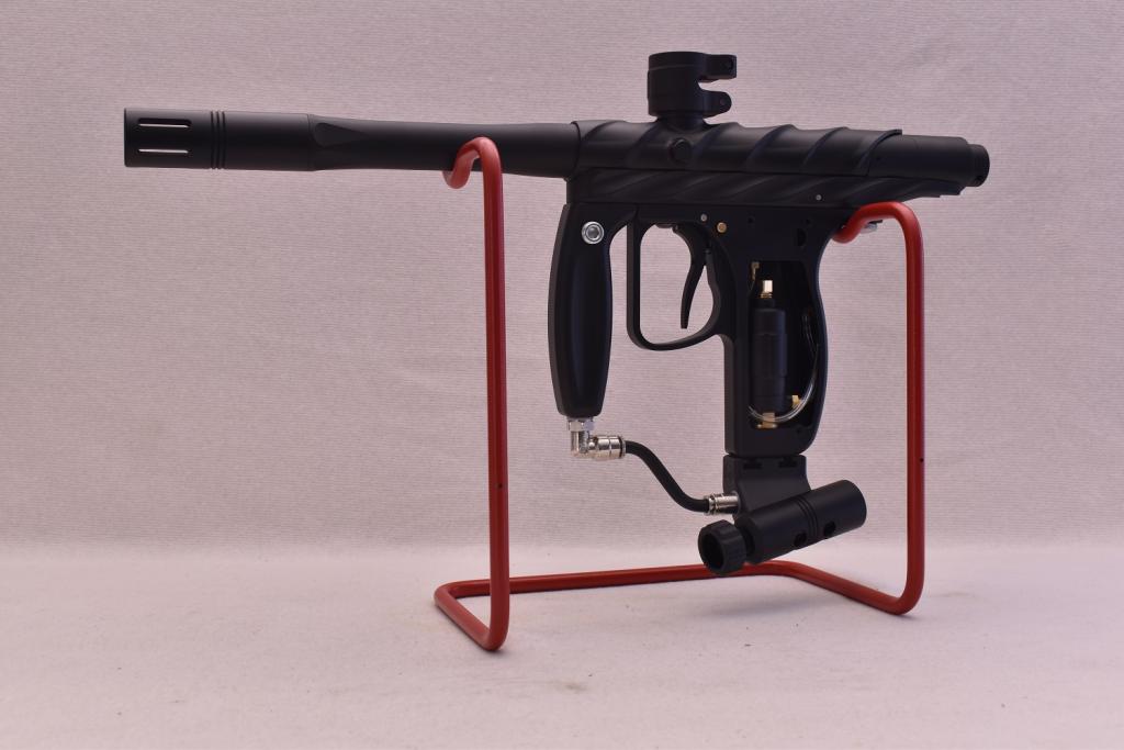

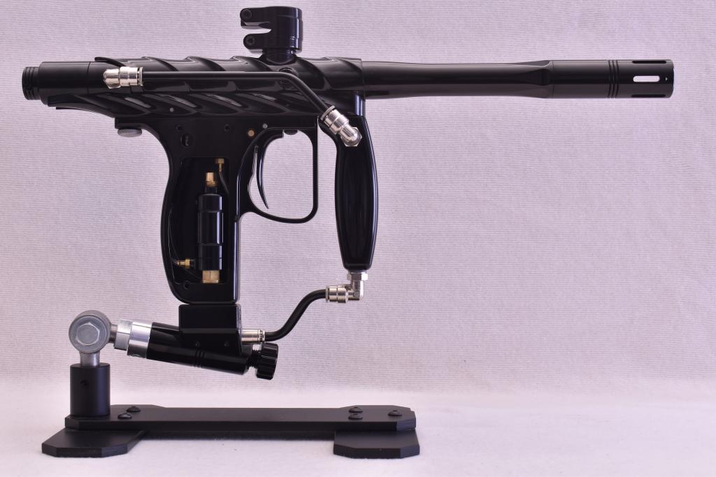

                            #118
                            Wave 8
Name:	Wave 8 Red Stand 2.jpg
Name:	Wave 8 Red Stand 1.jpg

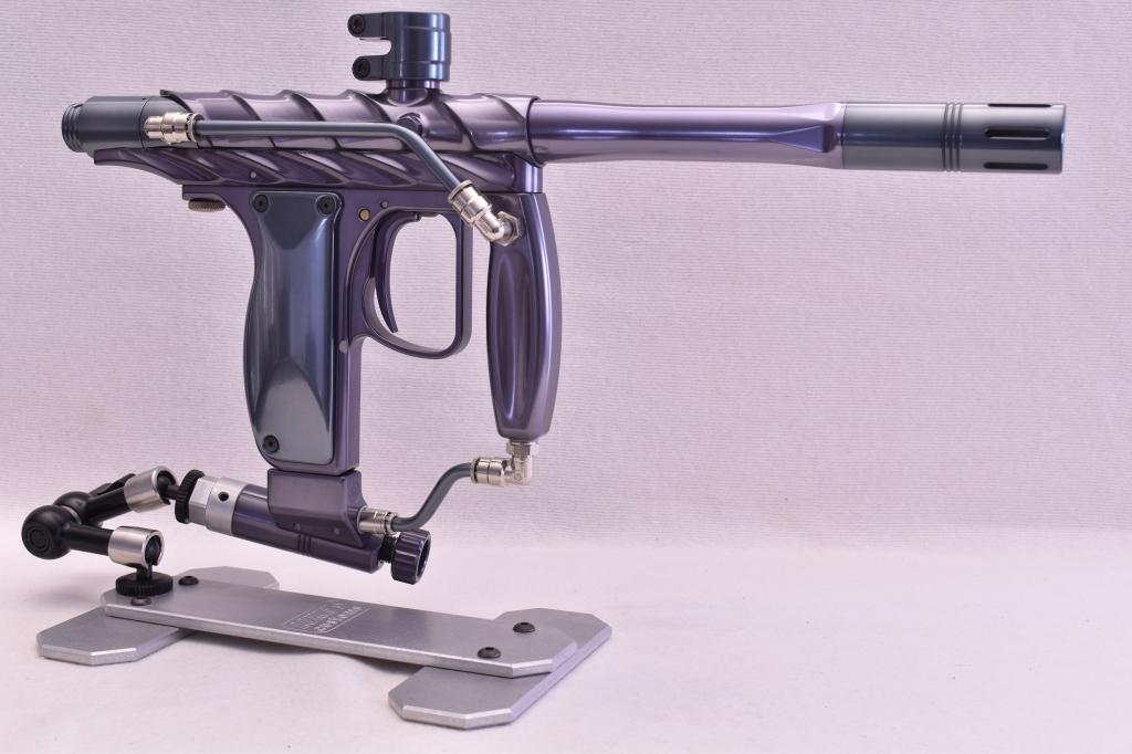

                              #119

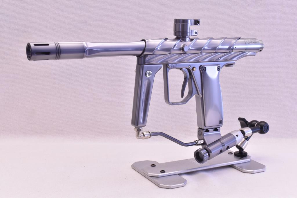

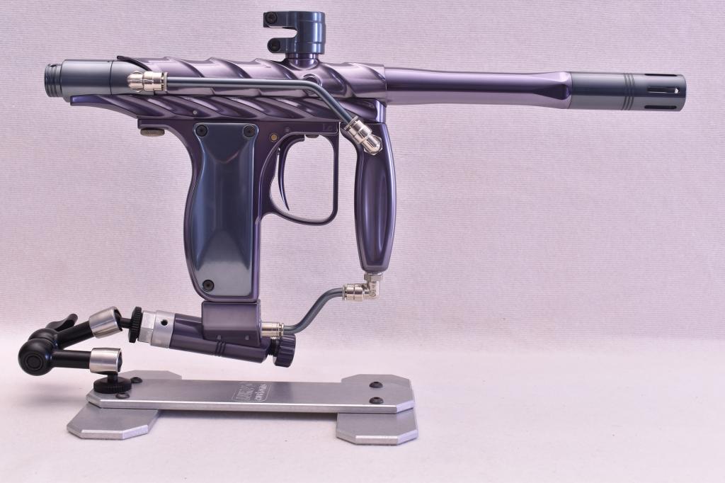

                              Wave 8, T-rex, MP90, Micro Wedge
Name:	Michael Lynn b.JPG
Name:	Michael Lynn a (1).JPG

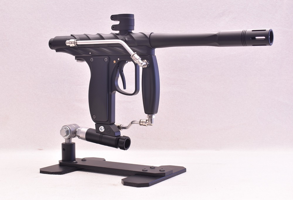

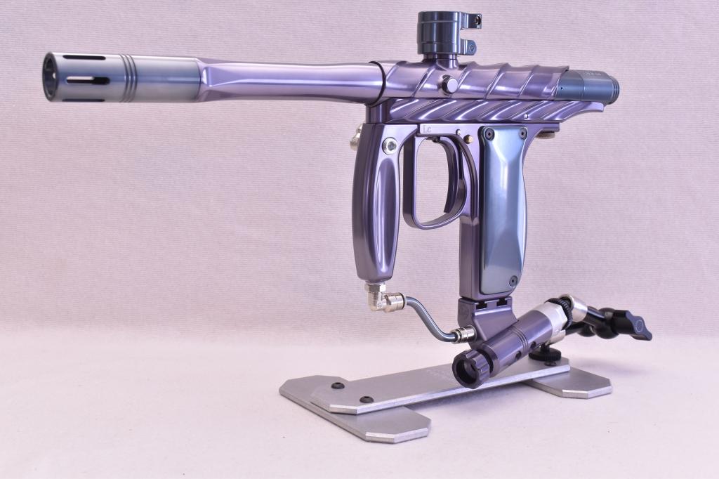

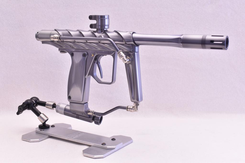

                                #120

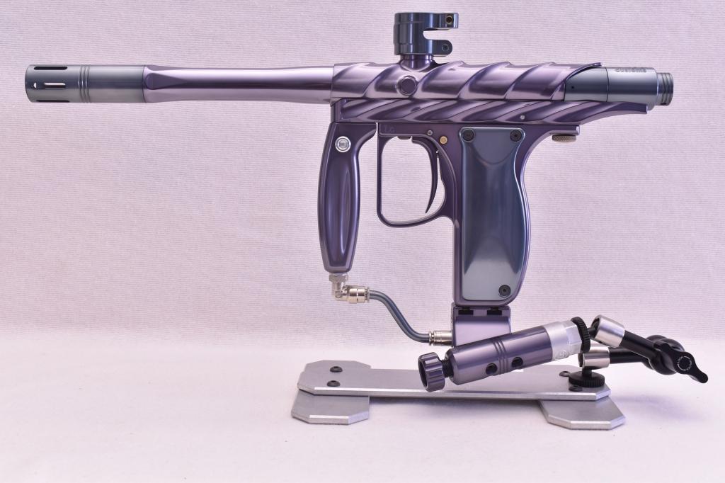

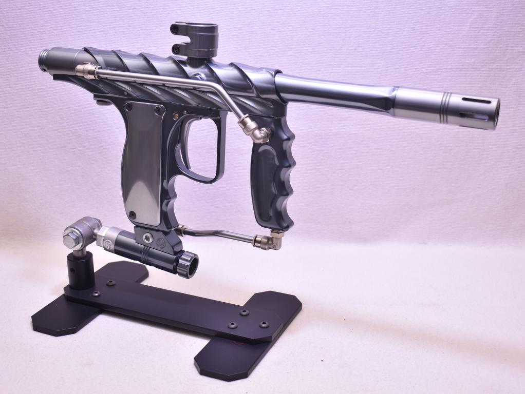

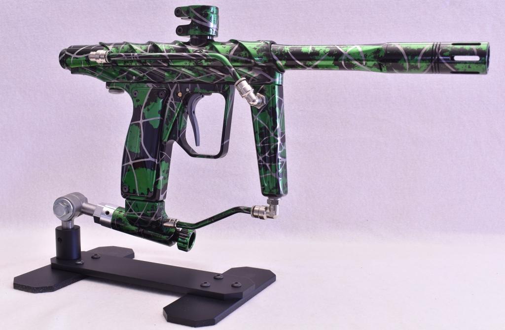

                                Two tone grey
                                Wave 9.1
                                LcX valve
                                New MP90 w/finger grips w/Ultra Blade
                                T-Rex with P90 LPR
                                New FG
                                New Micro Wedge ASA
                                Hardlines
                                Lc detents
