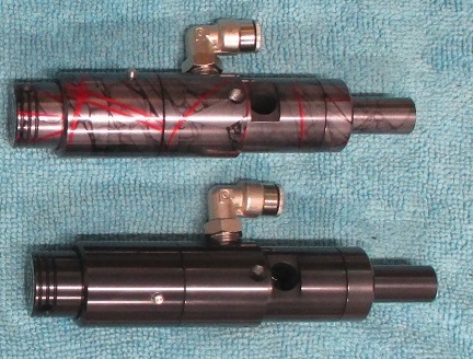

          My goal has always been to make parts as light as possible but without sacrificing the strength and integrity of the parts, strictly measured by my engineering, manufacturing and designing rules of what's what and why. That said everything I make could be even lighter but you reach a point of diminishing return in quality. It's a bit of a balancing act so I dont get to wrapped up in final weight, that said Lc markers are every light.
          About the valve, I do make my own LcX valve now.
          I've never compared the weight difference between mine and the AGD X (yet) still finishing up production on my internals.

            I was shooting for 1.25lbs and I could have gotten there but I was starting to loose tha shoot ability and aesthetics with the limited tools I had. I bet 1.25lbs would be pretty easy now.
            Those valves look nice! Same high input pressure reg as agd, or lower pressure? Any idea what the final price will be? Very interesting.

              It's still an X valve
