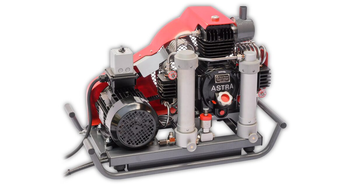

      http://www.protecair.com/
      Manufacturer of high-pressure ASTRA compressors for scuba diving and firefighting · 220/330 bar, 90–280 l/min · Service & spare parts in stock
