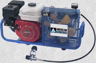

              At $2995 (basic), this is about as cheap as it gets:

                Has anybody ever actually used one of these portable compressors? I would like to hear about it. Pro, cons and the like.

                  Pito, the big tourney's will have a battery of them set up and hosed in to multiple stations. Complete teams can all fill at once.

                    those small air compressors take about 10 minutes to fill a tank, only one, a cascade system is necessary to fill fast, if there are any questions about what a cascade system is they are very complicated, id call it a bunch of reserve tanks all trying to push air into your tank at once for a fast fill. large compressor and a nice 2-4 tank cascade system is very expensive i know it wouldnt be worthwhile to buy one unless you did it for a living.
