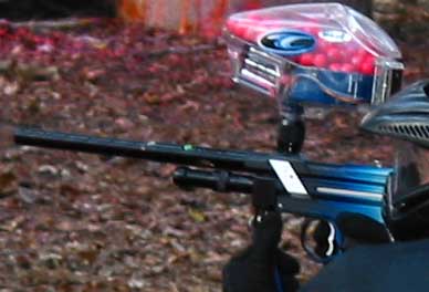

              • AcemanPB
                Exactly
                • 1885
                I'm not too familiar with timmys but isn't this a GZ? If not it's a cool fade anyway.

                      • DryIce
                        Team Crime Scene
                        • 471
                        my teammates GZ
                        Baseone Paintball
                        Blue Freeflow Matrix #7 of 15
                        Old Matrix #649
