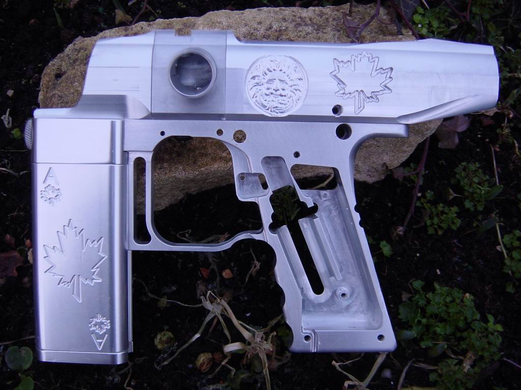

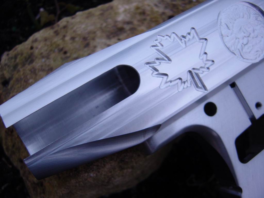

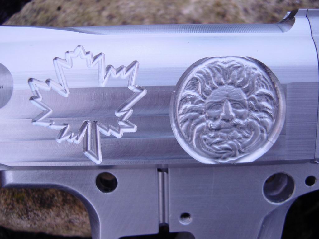

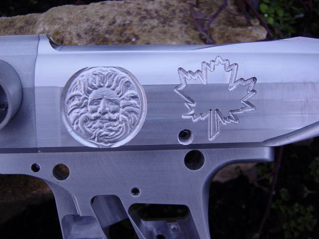

    OK Guys, I checked with Bob (RKL) and he is happy with me to show you some pics off the mill of his custom gun. The gun is in the raw so it's hard to see some of the work due to cuttermarks which will be gone when it is anno'd.

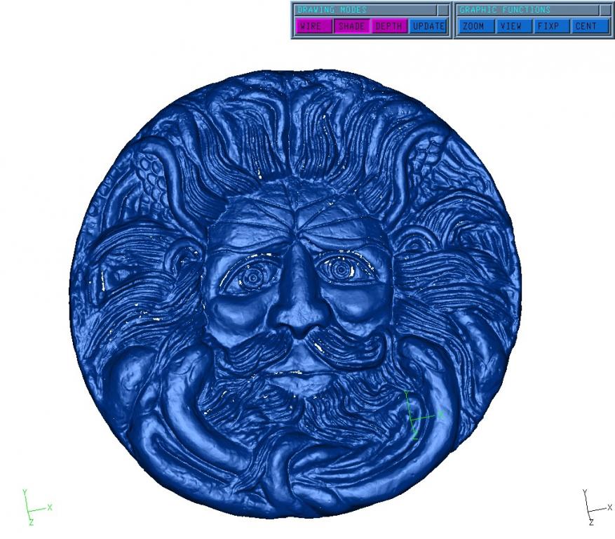

    This gun is I believe a first off in the World Of Paintball gun's ever! Why? Let me tell you about a process called 'scanniing'
    Bob had a wall plaque of a face image that was about the size of a dinner plate. He wanted something similar to commemorate his time spent in England (he's from Canada as you can tell from the gun ) on his gun.
    So we scanned in this wall decoration to make a virtual CAD file of it as an STL. I then manipulated this and shrunk it and embedded it into the side of the gun. We then recut this smaller version in the gun. It stands out proud like a real face. This process of reverse engineering is making huge waves in the CAM industry and has phenomenal potential, I work with it to do everything from full cars to small decorations.
    It's the first time I've heard of it being done to a paintball gun.
    I'll copy in some of an e-mail I sent Bob so you know other custom features I made into this body/gun.

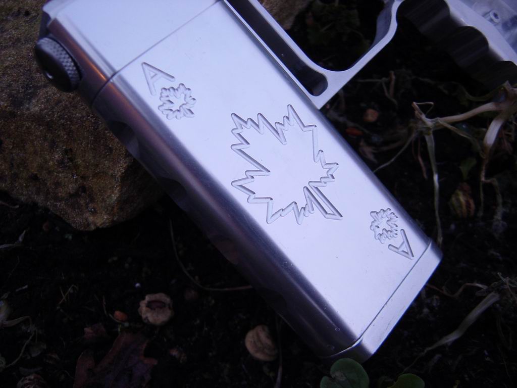

    "The Canadian Contingent (edit~ a Team Bob and I play for) patch is represented by the battery pack with an 'A' and tiny maple leaf in each corner and one large one in the middle, and you have finger dents on the front of the pack.

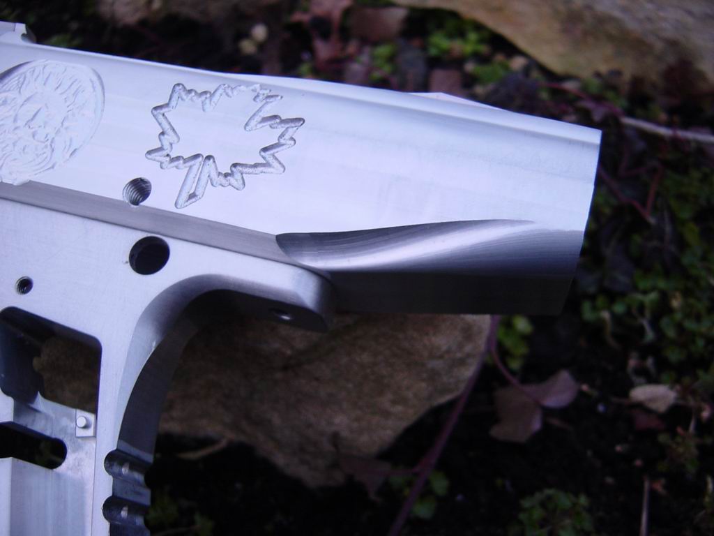

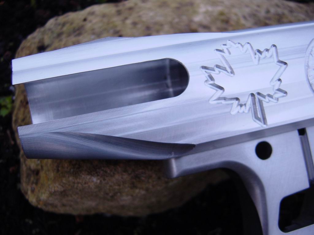

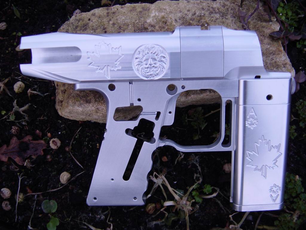

    The body has the sides cut flat to make it lighter but it still covers the valve as much as possible. You have a C&C top site rail and front top. You have a special fillet and negative swish on the rear corners. You have the Bath Image milled as a proud (as a normal person's) face (but in the body so protected from damage) on both sides. You have a Big maple leaf on both sides (edit~ which sculpts around the curved body).
    The grip frame has the second finger recess. The cut down back strap and button locations. And it has the front finger grooves."
    DISCLAIMER: This is a custom gun done for Bob. It is not something you can currently buy from AGD or AGDE. It is something I did for a friend of mine. Having me do custom work on your gun can/may void your AGD warrantee if they haven't approved it before hand. I do not work for AGD, I just have helped them before on some milling projects.
    OK so now to the pictures. Please respect what is in this thread, to be honest neither I nor Bob cares if you like it so negative comments can be kept to yourselves please. The important thing for me is that Bob likes it and that it reminds him of a good stay in England once he returns to his native Canada. :)

    More Pics

      I like the battery pack. The body work is just a bit too much for my taste though.
      Nice job though.
      Me thinks I recognize that leaf!

        wow, /me likes the sun.

          WOW!!! Manike, that's awsome!!! Seeing that I'm from Canada too, I like it even more... Can you do some milling for me?

            Beautiful work Manike!

                The detail on the face came out quite nice Manike. You should post the original scan so everyone has an idea how good it looks.

                  The original scan is:-

                      I like the battery pack a lot. Is it just me or did the idea come from an ace (playing card not anti chop). I think you are the first to apply that technology to milling a marker, send it in to Guiness. Or just buy a pint of Guiness to celebrate:)
                      • Kevmaster
                        Owners Group Div: Director
                        • 5475
                        looks like an ACE to me there...and i like the gun, i think the head looks awsome(maybe should be alone up top, the canada leaf is down on the batt pack), but overall, i love it

                              Yes the battery pack is based off an Ace of Spades Logo. This was not my idea, it's actually the logo of the Candian Contingent. A Rec team Bob and I play for (they made me an honorary Canadian LMAO :) )
                              Here is their logo which the idea came from.
