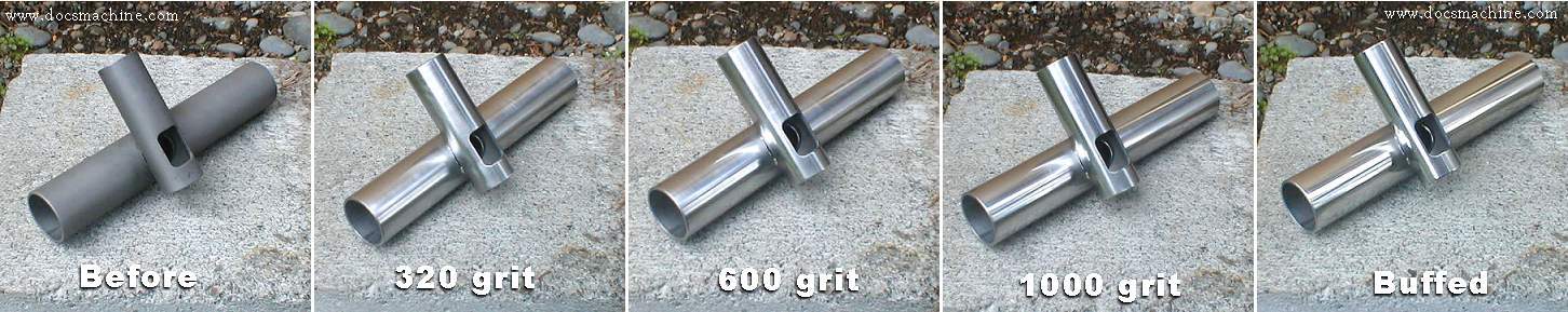

    ok i was wondering how you would polish a mag to a chrome finish without sending it to a pro shop

      yeah because i have heard of people doing it themselves... with like sandpaper or something but it takes a long time

        Whoaaaa buddy sanding is anti-polish. go to your local auto parts store or hardware store and get some buffing pads and buffing compound in the car care section. strip your gun down into peices and rub away!
        If you have a bench grinder you can get buffing wheels for them which would take alot of the hand work out of buffing your gun.

                thanks nj but what did you buff with

                  Personally, I went the extra step and went to 2000 grit. Don't know whether that helped but eh.

                    I went rummaging through my mom's polishing cabinate, i'll try to find what it was.
                    Oh and spaceddedybear, I only went to 1000, but I used two differnt kinds of steel wool after that. Those really made a difference, probobly similar to your 2000 grit.

                        Just wondering, could you use a dremel with the buffing head instead of the bench grinder with buffing wheel??

                          dremel works fine for final steps, but takes forever and a day... Also, it is hard to get in around the powerfeed tube, even with the little cable extender for the dremel.

                            does anyone have all of the steps.... do you have to go fro mthe 320 grit all the way to the 1000 grit... i have access to a dremel with extender i jsut need to know... dont wanna screw up my mag thanks
