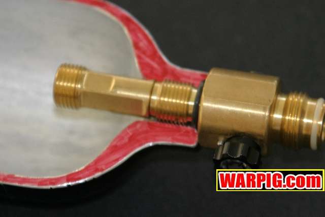

    Dayspring, if you look closely at the SP co2 valve, it is about the same length, but, it has a saddle cut to bleed off co2. Now the real problem is this, the threads stop at the saddle cut, then start again farther down. so what can happen is that IF the tank comes unscrewed and starts venting, it can jam the bottom threads right up to the inside neck of the tank and mess up the threads on the valve or the tank. so if something happens like that, you will have to buy a new tankand/or valve. AND if you are just removing it to change it out or such, you can easily booger up the second set of threads on the valve, trying to get them lined up, to unscrew. Way too much opportunitys to cross thread the SP valve, IMHO. "Oh and ours came out first! (IAO for ours, WC for theirs) SC villiage order over 200 of them to replace the valves in there rental tanks, hows that for an endorsment?
    And as Tater said, the new screw-ins have the same type channel to relive pressure before the tank seperates from the bottle. Also, due to TSA guidlines (the airline security people) regs will not be using any thread locking compound, so that they can be easily removed for airline travel. but will be torqued onto the bottle.

          FYI- Smart Parts' valve
                It looks to me like the whole valve/bottle could fail at that point and turn the bottle into a missle. The large cut looks like a much better idea.

                          #27
                          There is yet another advantage to the aa co2 valve, once it starts to leak the person will obviously begin to hear before it truly becomes dangerous, and since the channel cant be plugged by thread lock that will always hold true. Im sure that the valve that came off and killed that woman gave very little warning sound since it was plugged it would not have made much noise till it was too late.

                              And Remember, the new screw-in HPA tanks, have the same type feature as the co2 valves! it has a channel cut into the threads to release all air before becoming a missile.
