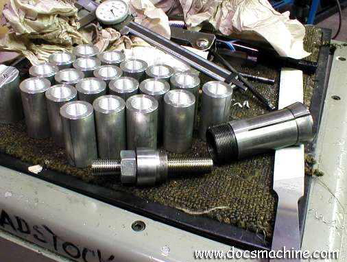

          I went back and looked at Doc's adapters, and I was slightly confused about their configuration. I didn't realize they required you to disassemble the marker to install them.
          -That's correct. They're pinned in place by the barrel-locking pin, a feature I used so that the body wouldn't twist when you try to unscrew the barrel, and it also can't shift in the twist-lock groove, which would jam it from feeding.
          Mine also have three such holes, so the same adapter can fit in right hand, left hand, and even centerfeed and Sydarm bodies.
          Stainless cuts considerably slower than aluminum though, so that accounts for a good deal of the discrepancy
          That's a good portion of it. My lathe is a tad underpowered for trying to push a 5/8" drill through stainless, so I typically have to make several passes; centerdrill, then 3/16", then 3/8", 1/2", and then 5/8". I made a small handful a year or two ago to cover orders while the shop was making more, and I snuck over to the college machine shop- the teach there loves me - and used his one of big 7.5HP 15" swing Colchesters with a collet closer.
          I used a carriage stop and a homebrew collet stop that I also made while I was there, in conjunction with the collet closer, and was able to face something like 20 pieces to +/- .002" in about half an hour. (Not counting setup time, nor building the collet stop.)
          After that, using the same collet setup, I was able to centerdrill all 20 (took about 10 minutes) pilot drill with a 3/16" (took close to an hour, but I had to resharpen the drill about four times, and the flood coolant wasn't cooperating.
          Then, with the coolant sorted out, and with a freshly-sharpened 5/8" MT3 drill, I was able to punch them all the way through in one pass. I still had to stop and resharpen the drill at least once, and each piece still took two or three minutes each for a full cycle, but it beat my little lathes all hollow.
          I finished up all the precision work back at the shop.
          FARMER00: Snag yourself a short bar of 303, 304 or 316 stainless and try it again. You'll see how much of a difference there is.
          I could have saved time and money having my adapters made from aluminum, but I wanted quality pieces that would last as long as the gun itself. I'm very happy with how they came out- and none of the 300+ users have complained yet- I just wish they'd sold better.
