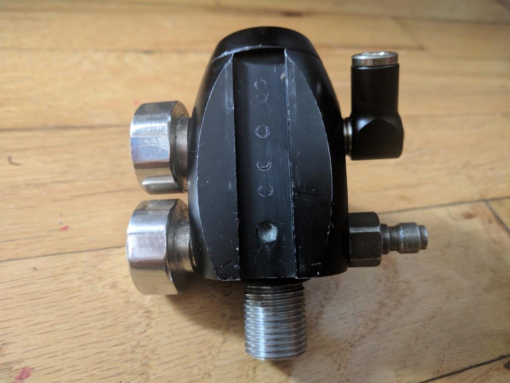

        This is the regulator, it's leaking from the gray circle in the dovetail area. I'm not sure what this is for. Any ideas?

          it almost looks like epoxy over a set screw eh ...

            That's kinda what I thought, but it also looks really nice to be a good job. I'm kinda afraid to try and dig it out and ruin something.

              It might be a set screw that holds something inside in the right place, and if there's a bad o-ring inside, it could leak out that way. I've had similar things happen with normal regs. So yeah, it needs to be rebuilt.
              Taking it apart shouldn't be hard. Just start unscrewing things, and pay close attention to how everything goes back in. Be patient. Take your time. Most everything is probably locktited, and you don't want to strip the set screws.
              Or send it to someone who knows what they're doing.

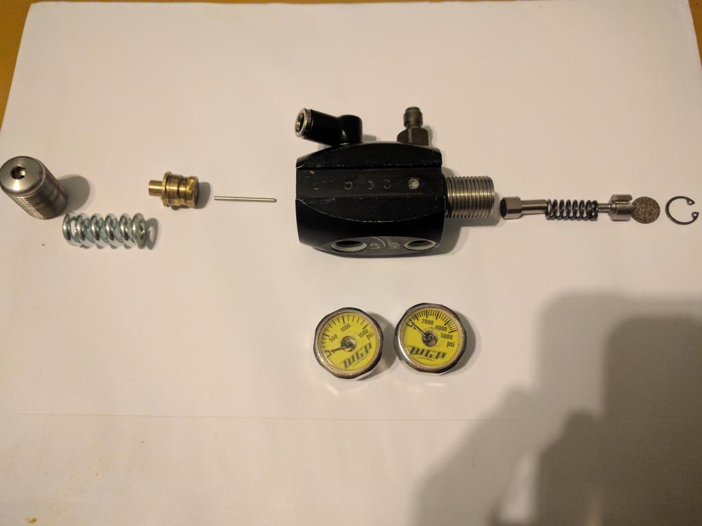

                I've had it apart. Everything internally looks good, cleaned and greased everything. Haven't had a chance to air it back up, but it still bothers me that I don't know what that gray plug is for or if it's supposed to be there. It is hard material, not something I can just pop out.
                My problem is I can't find any information on these regs, or anyone that knows 100% what's what about them.
                  [ATTACH=CONFIG]93489[/ATTACH]
                  Are you referring to the item that is second from the right in your picture? That looks like filter to keep particles out of the air stream.

                    No, he's referring to the gray dot on the top of the reg to the right, on the dovetail.
                    Any chance it's some kind of burst disk? I don't see any disks on the reg....which is odd. Maybe they built some kind of proprietary thing.
