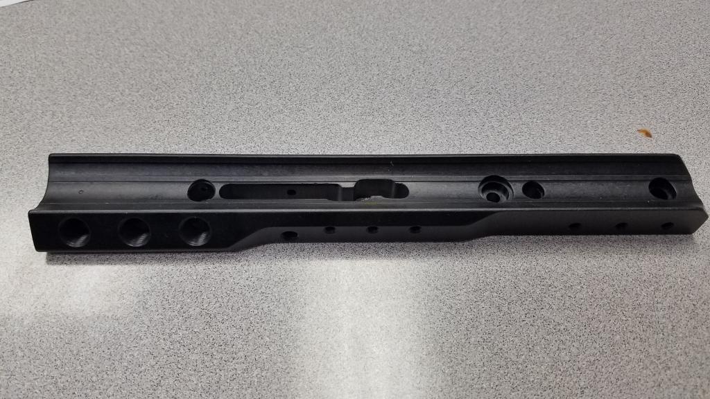

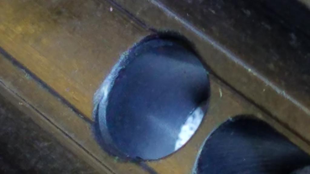

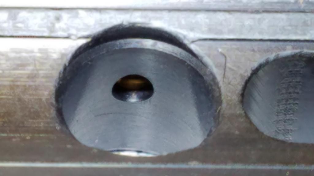

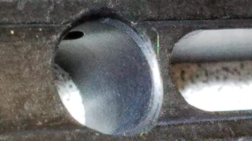

                    I have brand new rails I can see the deburring/chamfer groove on the top of the banjo hole.

                    Close-ups make it look rough, however, this is a new rail.

                    I guess I have to find an earlier bad one to really be able to know the difference.
                    It's good to know there was an early problem with that. Maybe keep me from pulling my hair out on a rebuild in the future.
                    Pinky, I honestly could not tell you on the rail I sent you. That rail looked perfect to me, however I have no idea of how early it was produced.
                    I'll assume it was a later production and the banjo hole was machined and finished properly.

                        These pictures show a chamfer to a counter bore on the high sides. It has been a while, but I don't remember seeing machining detail like that, just a chamfer/countersink that went up the sides.
                        I have a post mod pic, but nothing before-hand from that side (just the bottom, doh!)
