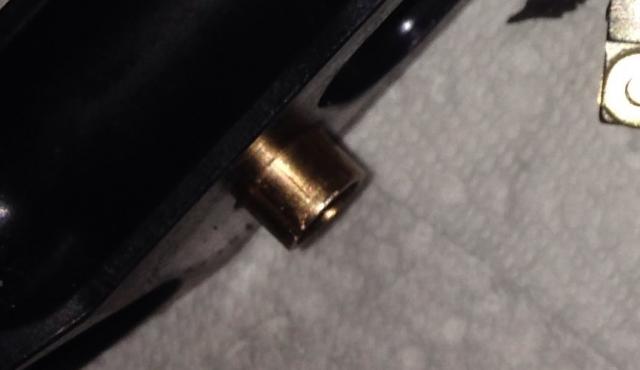

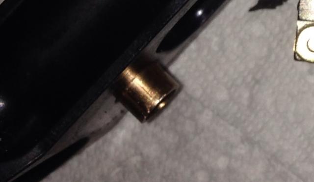

          Another question.
          How do I remove this piece that's pictured without damaging it. What about installing on my Armada rail?

            Should pull out with a pair of needle nose pliers. If not, use a vice and a couple of pieces of wood to press it out.

              Spot on. I just use needle nose pliers too. Only one time did I use something to press it out, and it didn't require a vice. I just pressed it against the floor until the bushing slid out. Can't remember what I used, but maybe it was a piece of dowel rod or something.

                Or you can buy new from Tuna.

                  Needle nose pliers work, but can damage the bushing.
                  A flat tip punch, hammer and vise will do less damage.
                  You really need a flat surface to lay the rail on when using the punch and hammer method because you can bend the rail other wise.
                  I have found some of the older style bushings and ones that have been in the rail for years very stubborn and wont budge with pliers.

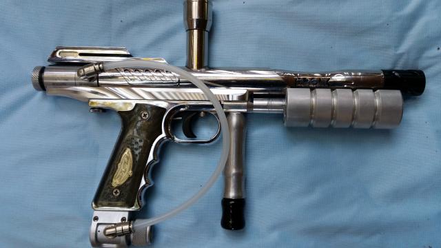

                          Might try put it on a ego mag.
                            • 8254
                            #118
                            Sweet! I like the pump...

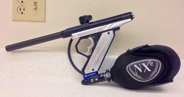

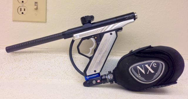

                              Here's a picture that would give people a general idea on how a z-grip sits on a Armada rail.
                              I just need to change up the CP ASA and rail.
