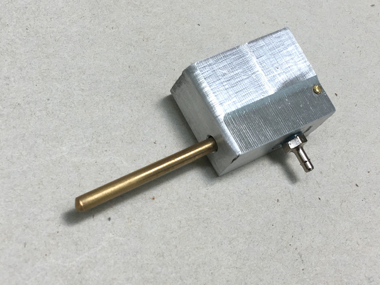

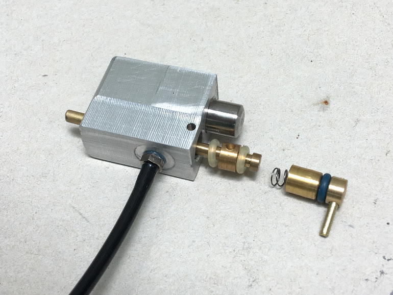

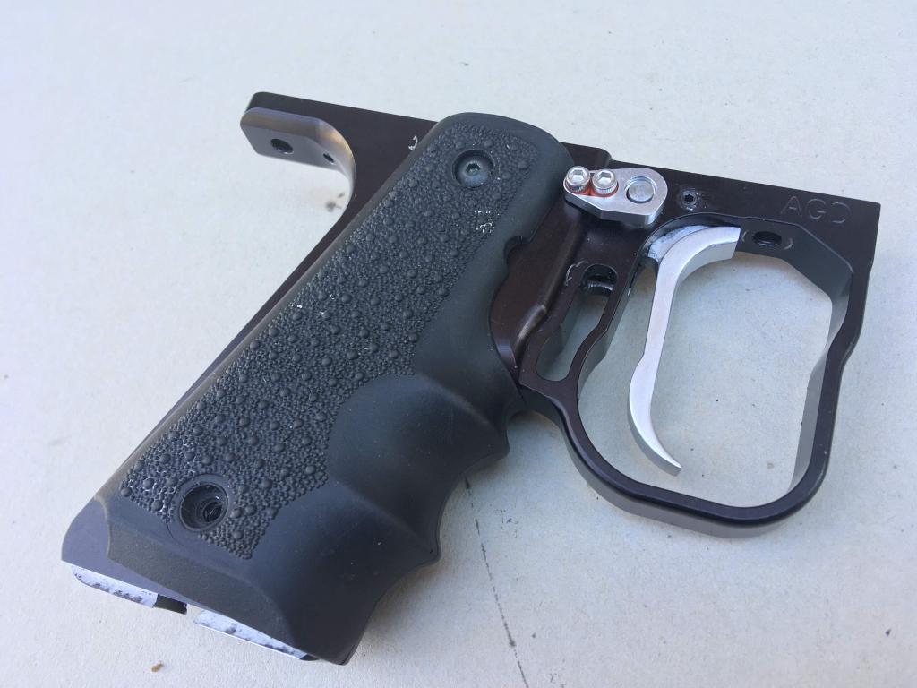

This…is the SPAR valve. Basically, it’s a Select-fire, Pneumatic, Auto-Response trigger valve for the Automag Intelliframe that cost about $150.

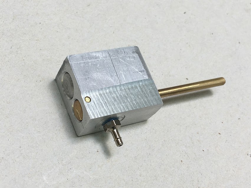

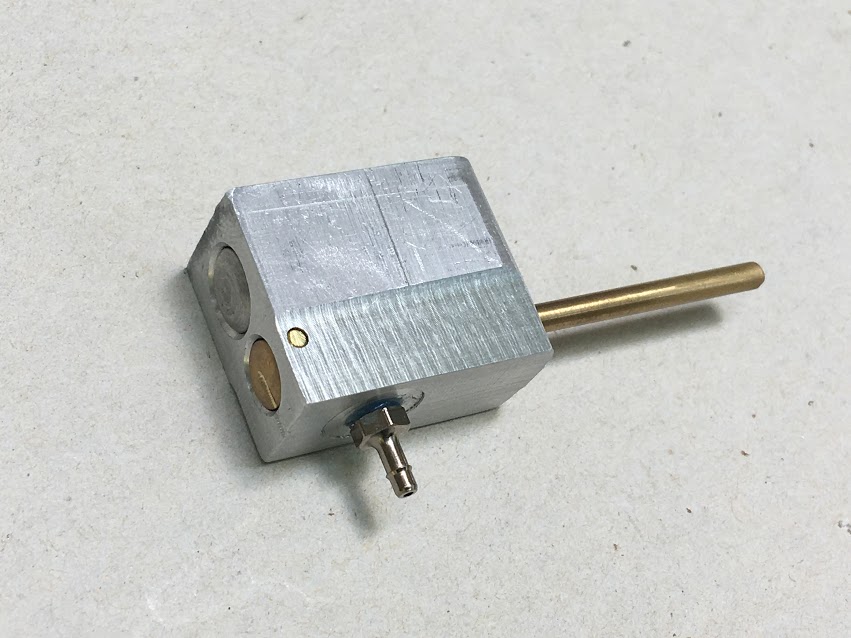

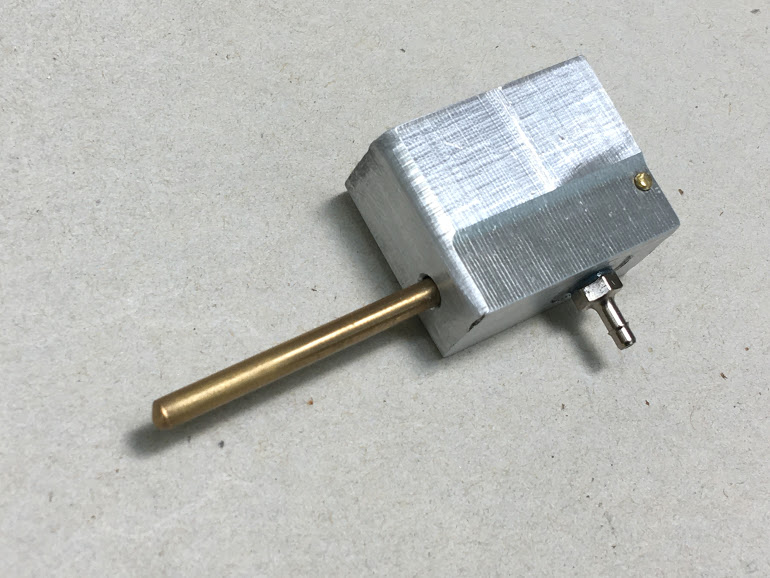

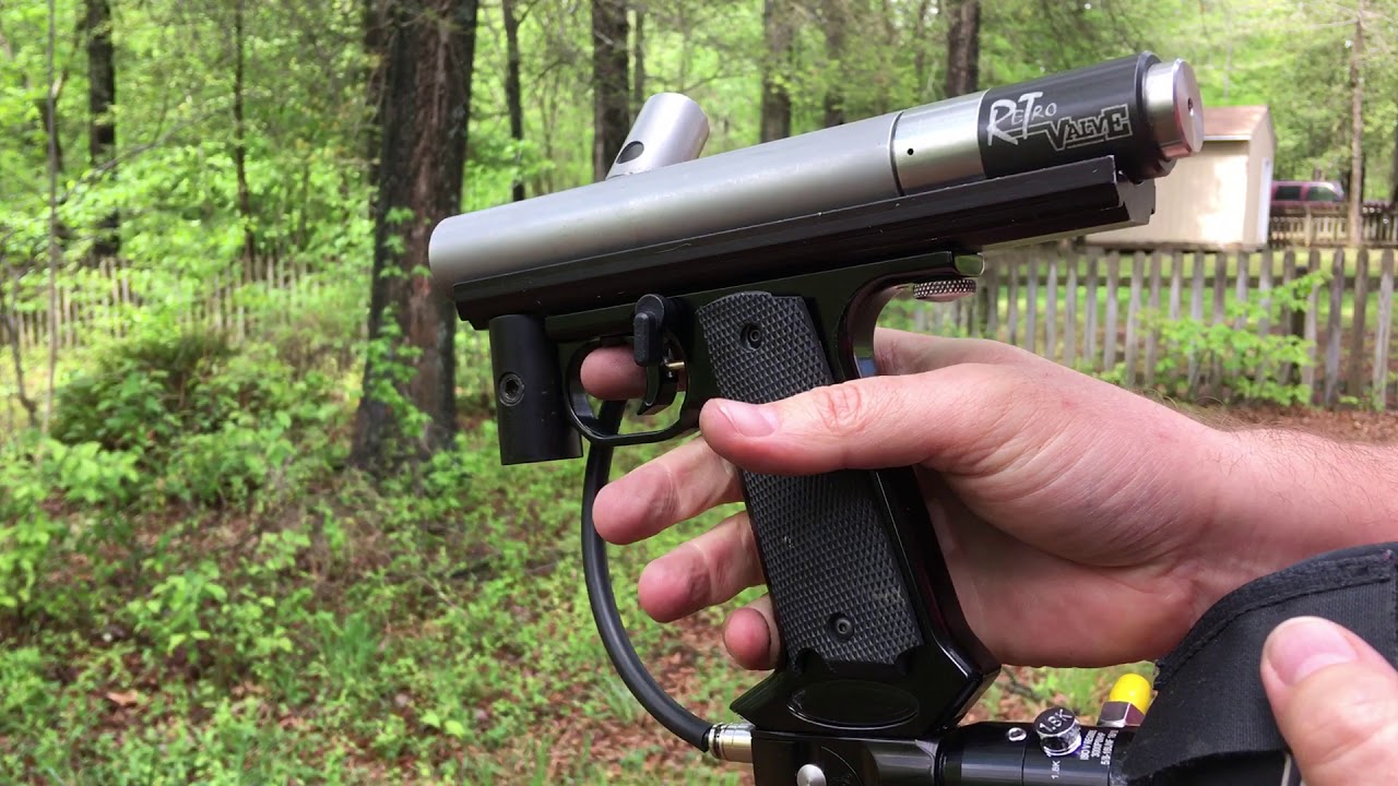

Shooting demonstrations:
1st Prototype
2nd Prototype with safety switch
3rd Prototype with single trigger frame
Production model with EZ ASA sleeper mod
Video Manual
The valve is mounted/hidden inside the frame like a typical pneumag set-up, but this can fire the marker on both the pull and release of the trigger. It also has a rotating selector-switch safety (E-MAG style?) with three positions: safe, single fire, and auto-response. This is a significant improvement over previous mechanical auto-response frames, which always fire twice with each trigger pull (even if you only want to take a single shot). The SPAR valve also has a much lighter trigger weight (about the same as a classic on/off assembly).

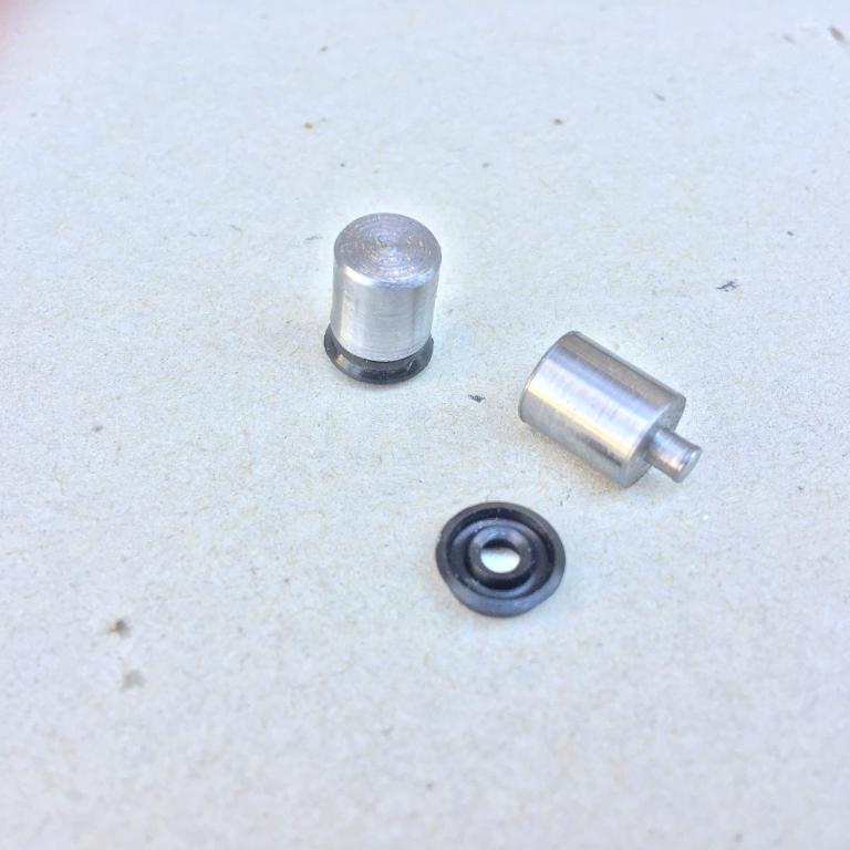

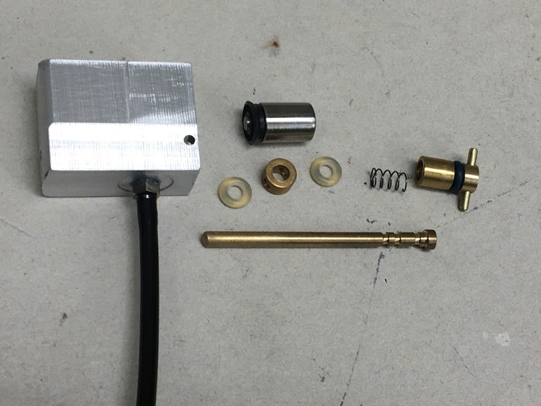

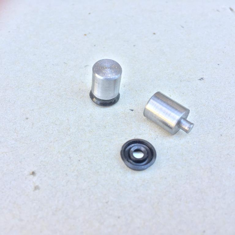

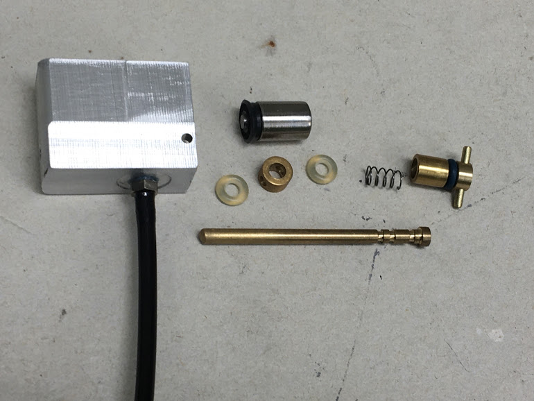

The valve itself is pretty simple. There are only two moving parts (the trigger pin and the piston), and the only o-rings inside are off-the-shelf #006 o-rings (1/4" OD and 1/8" ID) that are easily replaced. The internal assembly is held in place with a single 5/64 pin, so it's easy to take it apart and replace the o-rings when needed (probably once a year or so). It will also work on pretty much any Automag with any valve. X-valve, classic valve....whatever. You will need an RT on/off, however. A classic on/off won't cut it.
The piston is made from polished 5/16 steel rod. The back end has a nubbin that fits a u-sup seal. This is also easily rebuilt.

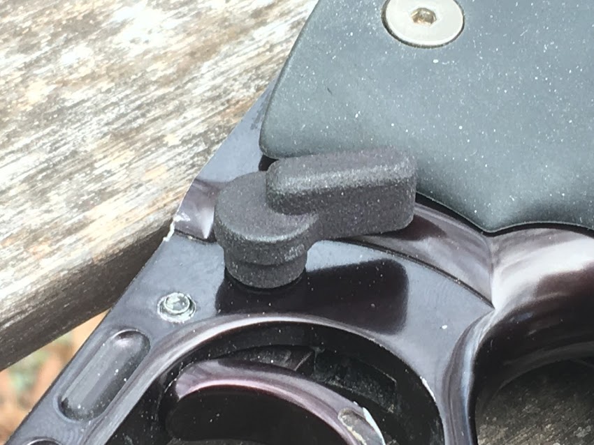

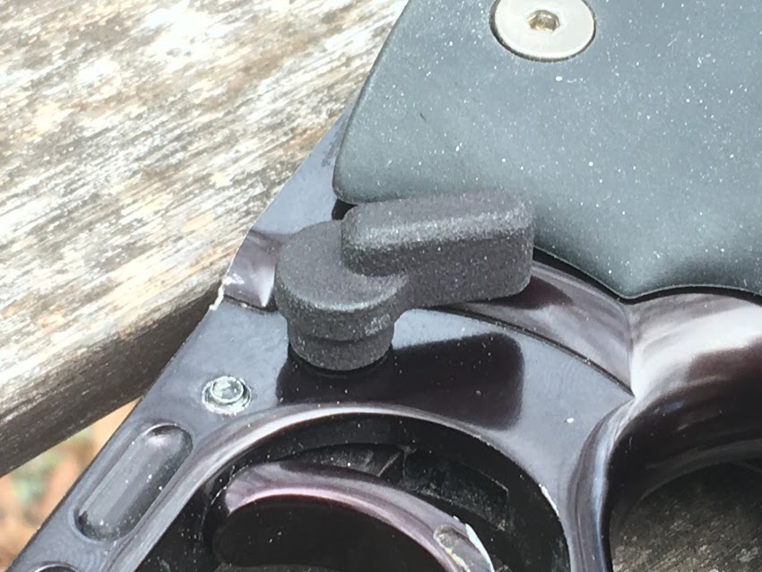

There are two safety styles: the servo arm and the 3D printed switch. (Big thanks to ArmageddonSportz for designing the 3D switch!) Both are included with your order, and they're held in place with the same ball-and-spring assembly used in standard AGD frames. The aluminum servo arm comes with two 1/8" 4-40 socket screws installed. You can easily remove these screws if you want, but I find that they make the switch wider and easier to move.

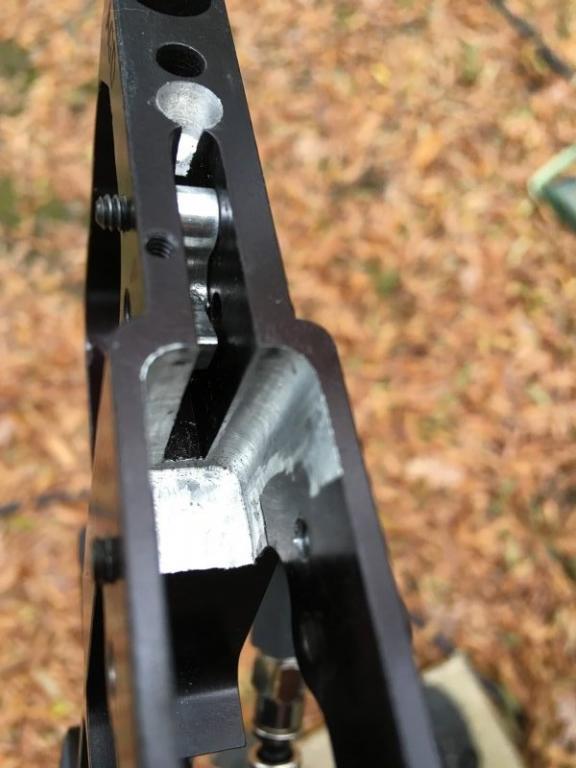

Your frame will have to be milled to make room for the SPAR valve. I will also drill a 1/8" hole in the back of the frame near the hole for the field-strip screw. This is for resetting the sear. (It's a common mod for all pneumag frames.)
By the way…I should note here that this modification will permanently alter your trigger. Besides milling the frame, I will also have to grind down the back part of the trigger to fit the safety. So, if you’re thinking of just trying this out and then going back to normal if you don’t like the valve, that won't work. You will have to buy a new trigger.
