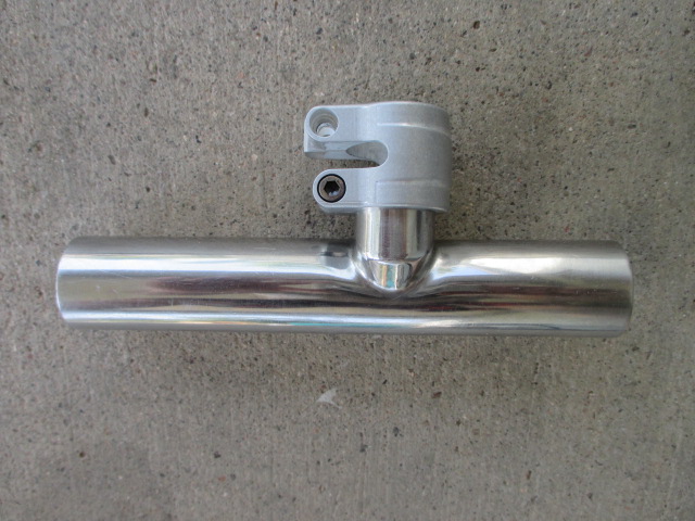

    Looking for a LAPCO universal vertical feed-neck, as they've been out of stock forever.
    I cannot use my marker without one, the plastic spyder ones suuuuuck.

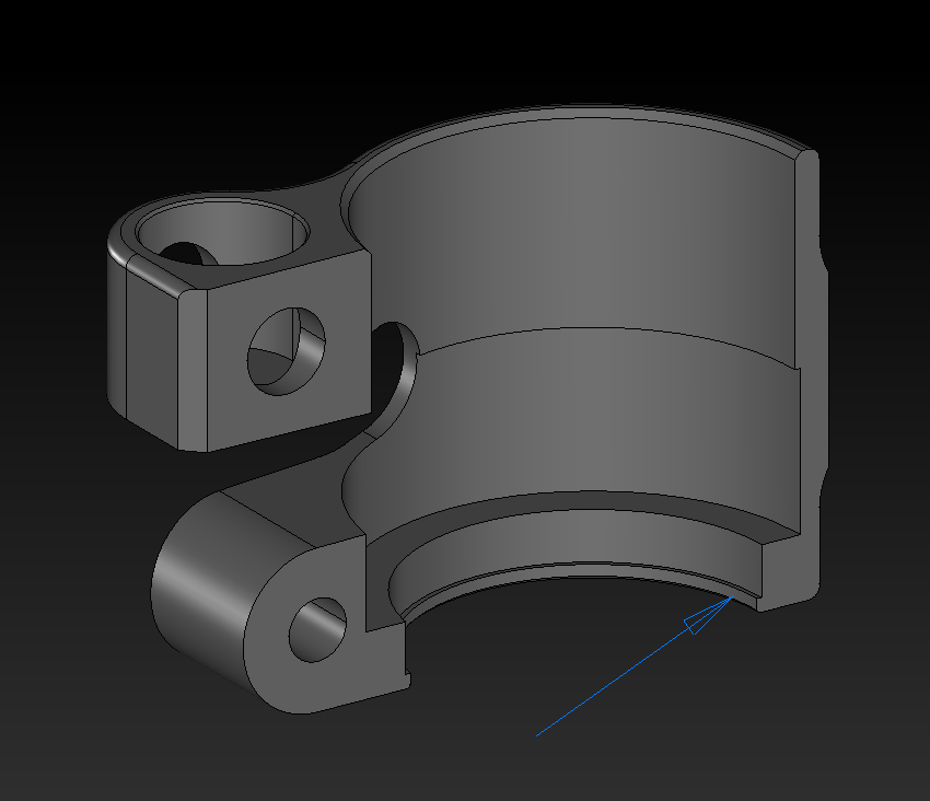

              I'm guessing you're wanting to do something like this? My feednecks clamp down tight in a setup like this without any mods.
              That said, a few minutes with a file or a mill to remove the little ring would be more ideal.

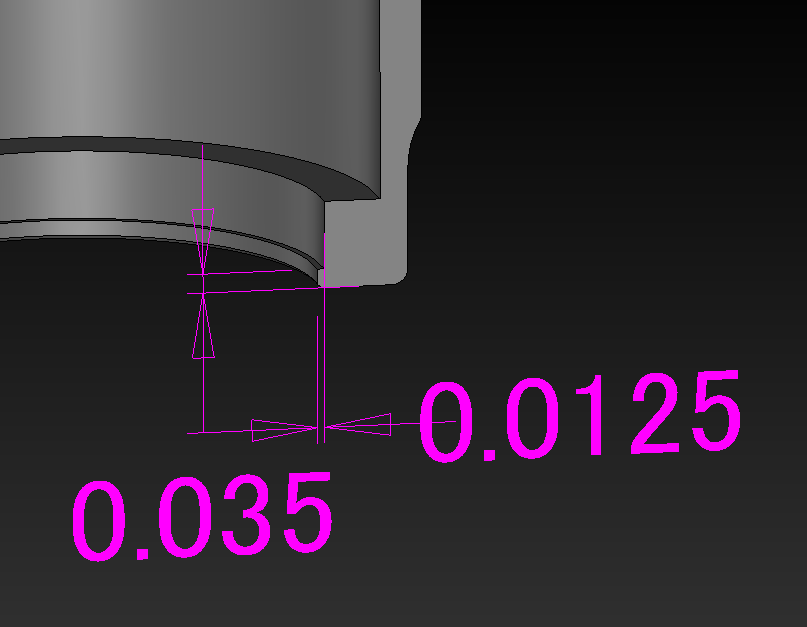

              The lip is very small

                      The feed tube I'm trying to fit for is .875 in diameter. The same 7/8 feed-neck that spyders use. It's for a forgotten marker that the threads are no match for any feed-neck that i know, my thread gauge is closest at 27 tpi, but it looks like 26 or possibly 25 tpi but certainly not 24. Unless you guys know the thread per inch of other feed-neck types then IDK myself. I haven't been able to match it up with any others yet.
                        • 8216
                        Gotcha, I thought you were looking for the Spyder slip-on feednecks. Sounds like what you really what you need is a 26tpi threaded neck ring
                          Yeah pretty much. FYI, its for an Inspire BFG. Also known as TG101 by Air Challenger, a Taiwan based supplier that also did the MG-7. Likely a 7/8-26 tpi threading but i don't know what other markers use that. It just came with a 7/8 neck with separate clamping adapter like the old vert spyders.
