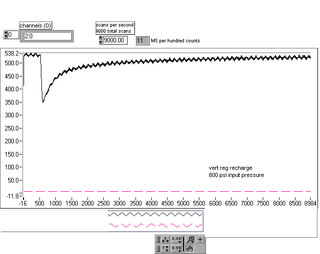

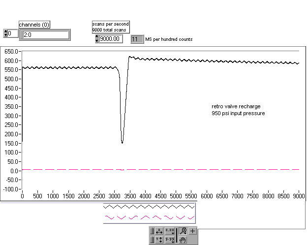

    RT recharge rate, graph spans one second.

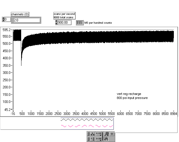

    • AGD
      The man from AGD
      • Oct 2000
      • 5916
      popular tournament gun vert reg, graph spans one second.

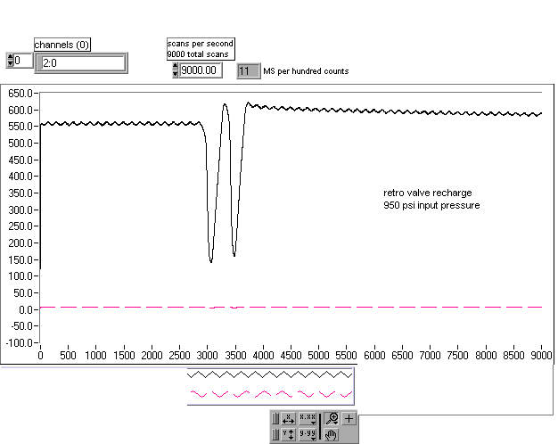

        The man from AGD
        • Oct 2000
        • 5916
        RT runaway mode two shots, graph covers one second.

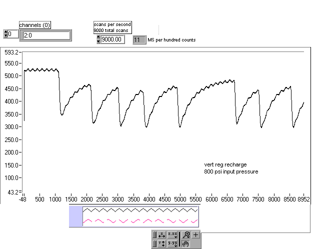

        • AGD
          The man from AGD
          • Oct 2000
          • 5916
          Angel, NOTE graph spans 10 seconds.
