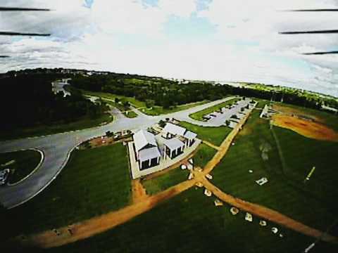

    The weather has really not been cooperative, but I finally got in a decent range test today. You’ll have to pardon the flying; the PIDs are still stock… from a different quadcopter. And I was getting eaten alive by mosquitos while I was trying to fly.
    Took a few seconds to lock in, but once it did, it stayed locked in past 300M:
    That’s not exactly recordbreaking, but I was able to put a fairly wide sweep on the area while maintaining a solid video link, and I might be nearing the limits of the micro RX’s range. (And that is a looooong walk of shame if I crash.) And this was still an urban area.
    The notable thing is since this is the ground station, it’s fully transferrable to a different model. I’m looking at building a larger (faster) brushless quad now that’s still under 250g and carries a Mobius.
