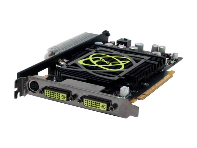

          Personally i would recommend a XFX like this one:
          XFX PVT71JYHE9 GeForce 7950GT 512MB 256-bit GDDR3 PCI Express x16 HDCP ExTreme
          http://www.newegg.com/Product/Produc...82E16814150189

            My machine is purely for web-surfing and gaming, thats it. I'm not sure what you mean by "rendering" as I thought that games required some rendering. In the past, I've bought on the tech curve, and as a result my systems have been outdated pretty quickly. On BF2 i have it set at the lowest setting, and still my fps would make anyone cry. I still rock though Thats why I want to be AHEAD of the curve, and buy a machine that might be overkill right now with what I play, but will still handle stuff well a few years out.
            I'm not opposed to a single 512 MB card, but I don't want to stick myself in a dead-end power-wise.
