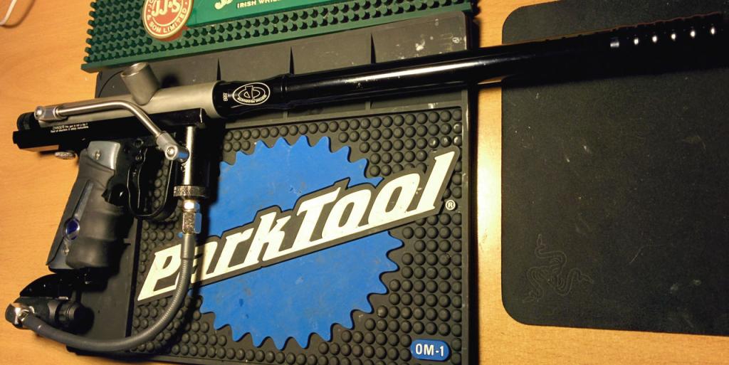

As purchased, post feedneck cutting:

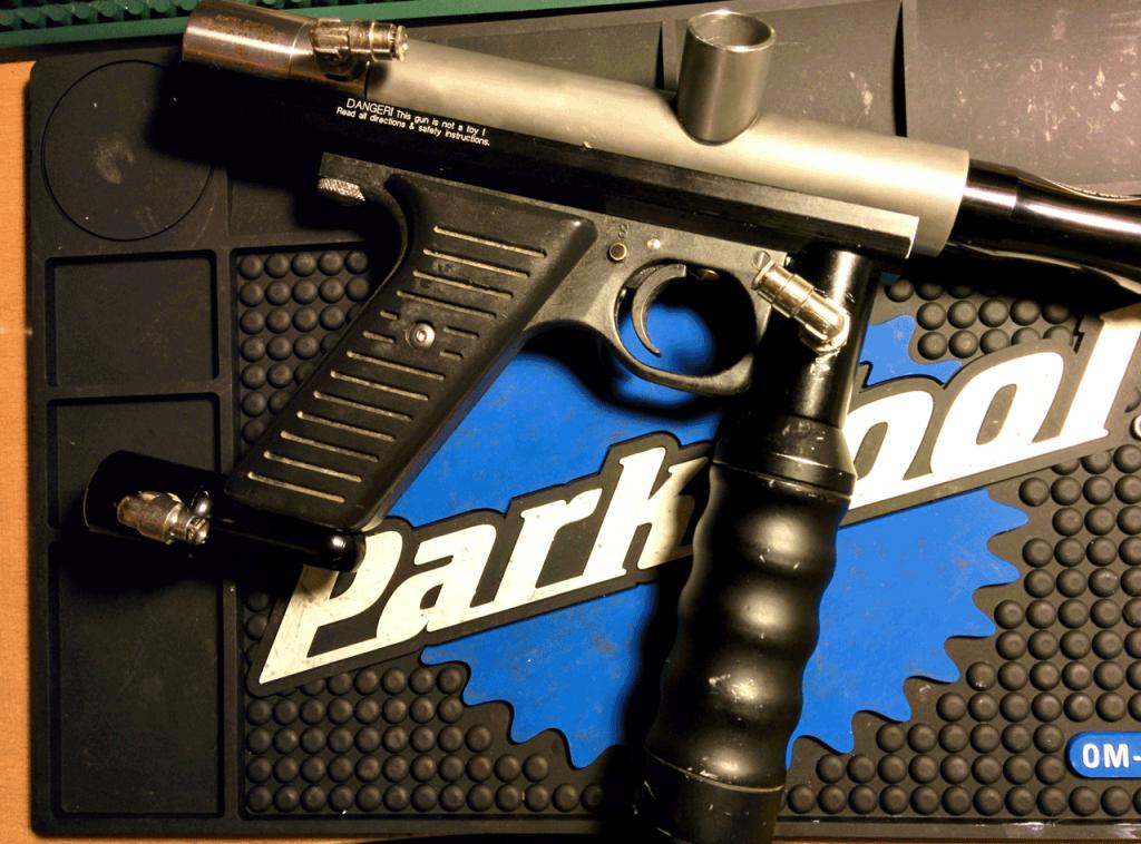

Valve as purchased:

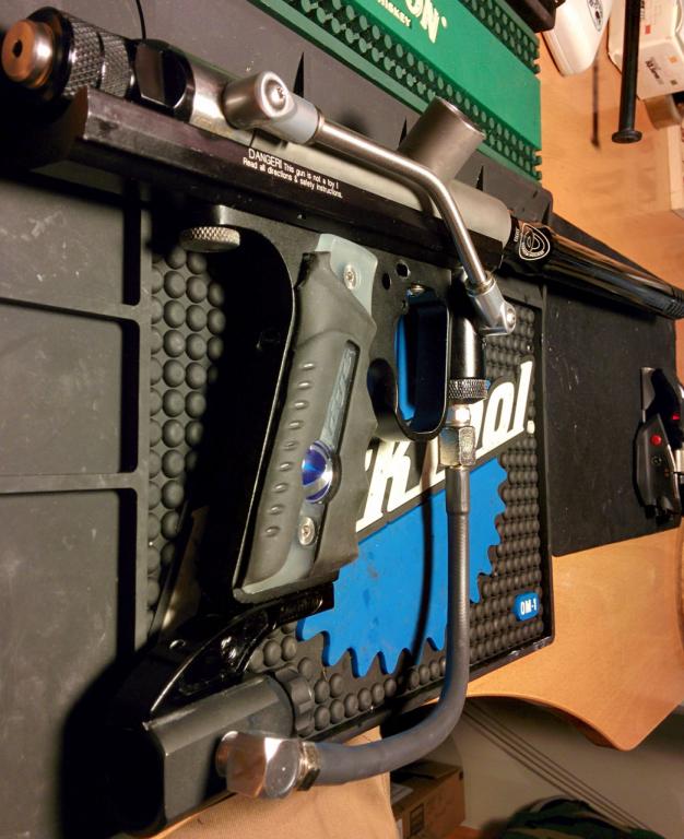

How she sits now:

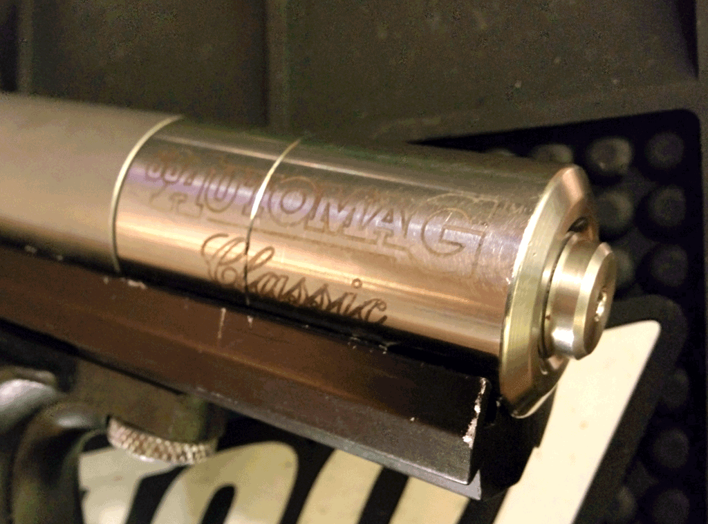

Now, from the valve end:
As purchased off CL:
-Classic right feed
-Microline fittings
-Old CP barrel
-unknown expansion chamber with a "B" on the base
After getting it cleaned up, re-lubed, feedneck cut down, and the trigger rod length back to stock, I went target shooting. Aaannnddd then I went modding. Please don't hurt me. I fully understand that the only way to improve any modified Automag better is to bring it back to stock. I just like doing things THIS way. After a fun evening, it runs quite nicely.
After modding madness:
-Superbolt frame (Dye UL Autococker knock-off)
-RT on/off
-Air America Black Ice reg bottom as a valve back
-CCM macro fittings (2 o-rings in each)
-Stainless hardline
-Heatshrink-covered braided line
-Some aluminum 90deg elbow from the spares box
-Shocktech #3 drop reverse
-CCM on/off ASA
So far so good. I'll maybe/probably install a Level 10 at some point. Already have a Centerflag Thunder reg, just need a tank and gauges. Running the ASA for now with a standard Ninja 68/45. And now, some pics!
