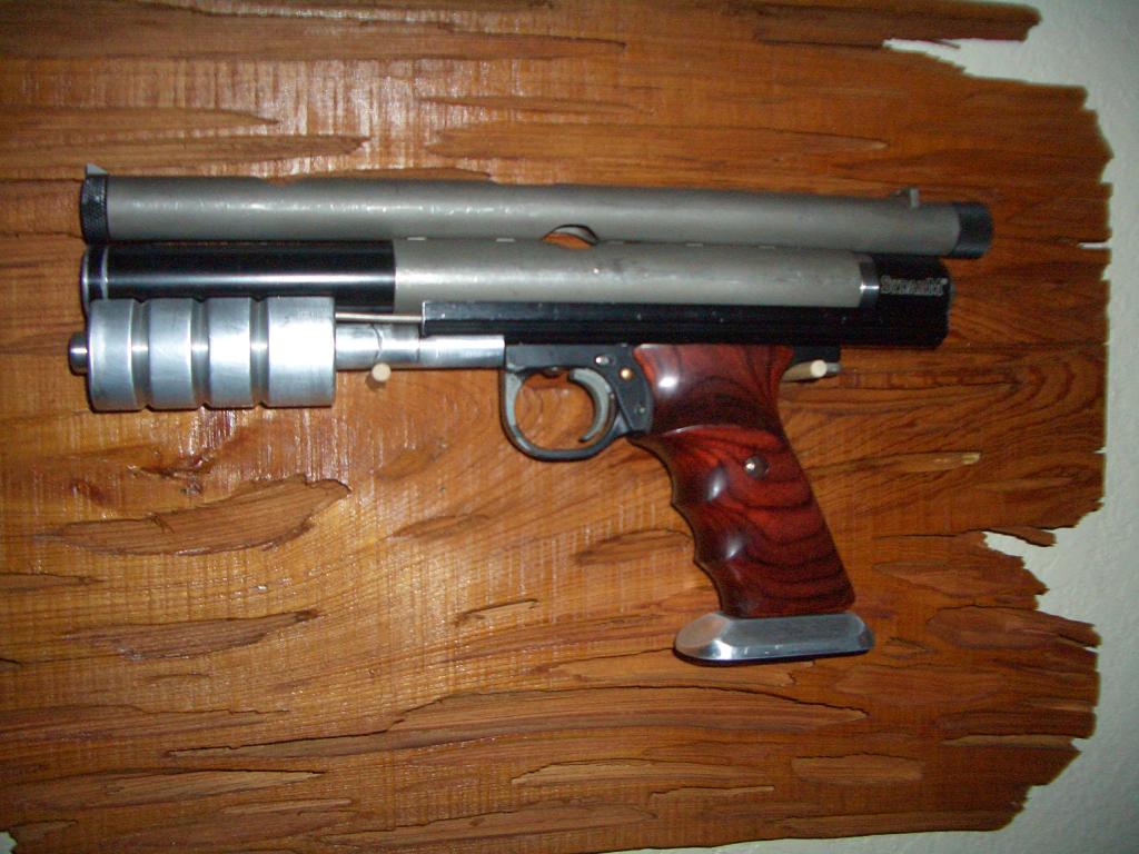

                • Runamok
                  http://www.automags.org/fo
                  • 866
                  I made a "target" type base pad, after unsuccessful attempts to find any affordable target pistol grips. And my wall mount board is wormy cypress. Makes for a beautiful home for the Sydarm.
