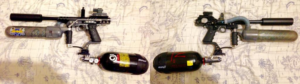

    My First Mag Project
    RT Classic
    Level 10 Bolt
    Doc's AC Thread adapter
    15" Lurker Barrel (0.685") with AC Threads
    Lapco Mock Suppressor with stuffing to mute barrel porting. Significantly Quieter!
    Rail raised for Laser with a custom piece screwed into the top of the stock rail sight.
    Q-Loader
    AGD Warp Feed adapter
    Not sure what type of Drop-Forward is on it.
    Datapimp attachment system.
    AGD Flatline 4500 (Output set to ~1050 psi), 90ci, 4500psi Ninja tank [New Setup]
    On/Off pin trimmed to 0.743"
Name:	Mag LVL 10.jpg
    Setup as of March 2016.
    Last edited by BassdudeBTB; 04-14-2016, 12:44 PM. Reason: New Setup, more mods. LVL 10, 15" Lurker Barrel, Doc's AC Threaded Adapter, Trimmed On/Off Pin, 90ci Tank

    interesting, how do you like the q loader?

      I'm still tweaking it a bit. I had too much tension on the drive spring so I was getting multiple feeding. Balls were pushing past the detents. The local field paint was a bit small so I'm looking into a smaller bore barrel. Otherwise it's nice! Easy to reload. It's my first Q-loader setup so I'm still learning all the tricks.

          Thanks! Any advice is always appreciated. I ordered an Eigenbarrel with a few control bores from Lurker. I'm hoping it will tighten up my shot pattern. I also installed my cocker thread adapter from Doc's machine shop and tried it with my CP .685 cocker barrel and it seemed better.
