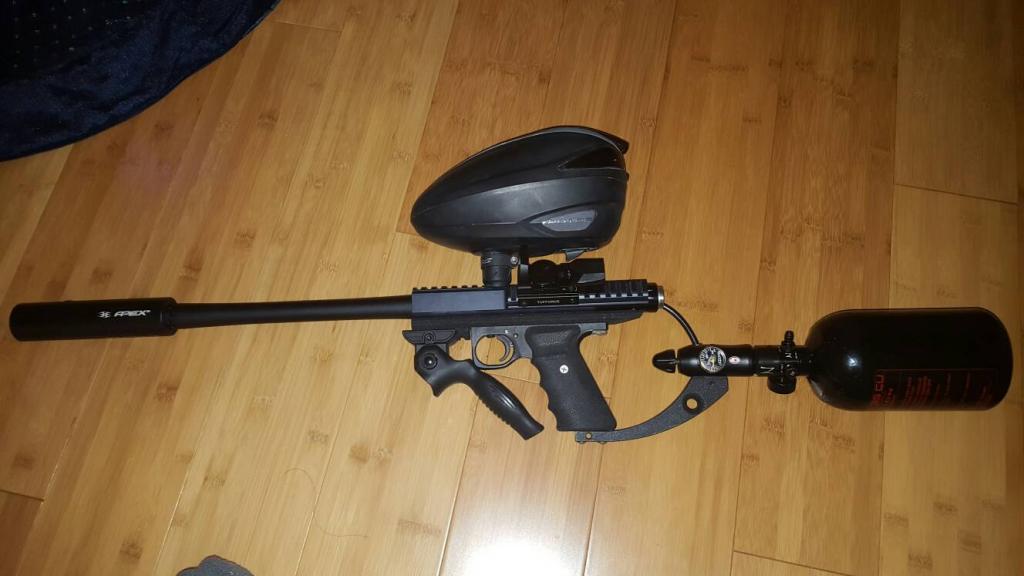

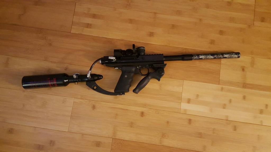

So I decided to get back in to paintball after a 5 year or so hiatus. I wanted to build something a little more milsim and comfortable for shooting. The Tac One is built on a 3d printed rail from shapeways.com with a utg 5 position front grip, x-valve, agd carbon fiber single trigger frame, a old drop forward I had in a box turned upside down and backwards and a cp on/off asa, ccm clamping feed neck. I plan on getting a rap4 spingfeed adapter and springfeed setup. I love the weight drop from switching from the ULE rail to the 3d printed nylon rail. Just want to get a different on/off pin for more rt bounce.
