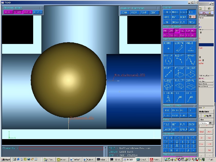

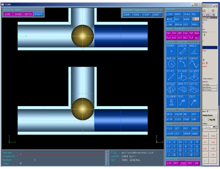

    Nice idea Mr Grumble but in reality you cannot start feeding the ball in that soon or closing the bolt so soon on a half fed ball. It's because of the actual shape of a sphere it's very limiting in terms of how far in it needs to be fed before you can start closing on it...
    I calculated it out years ago but to be honest can't remember my figures for how soon you could close the bolt without having a serious risk of chopping the ball... It made only a very small difference.

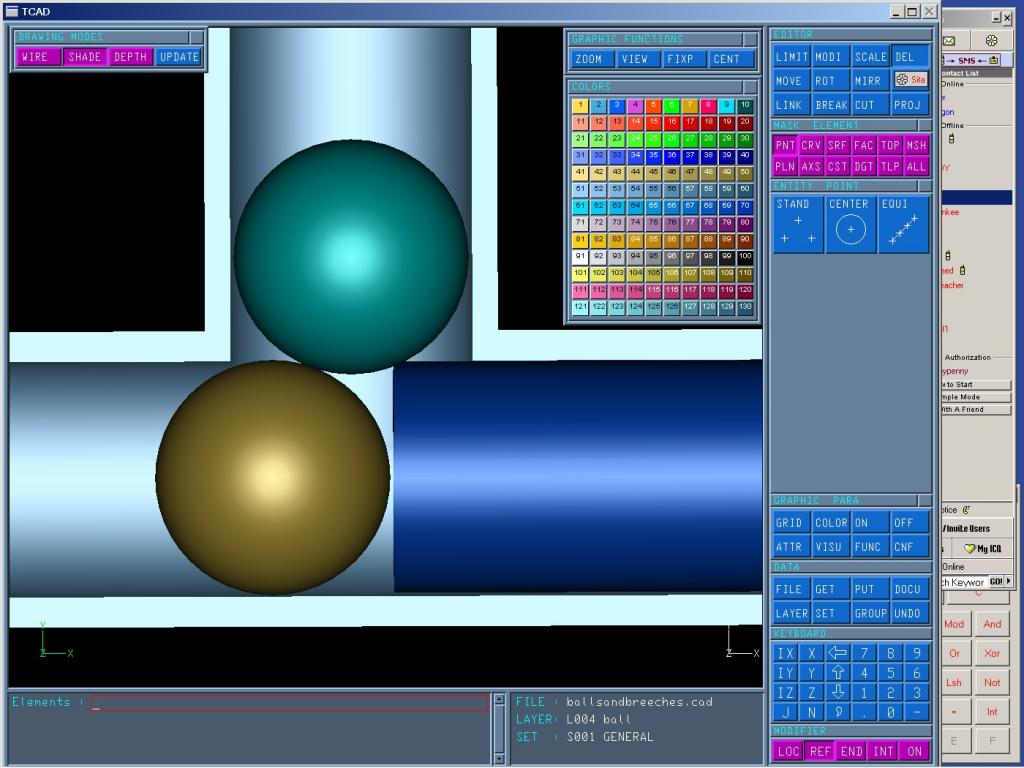

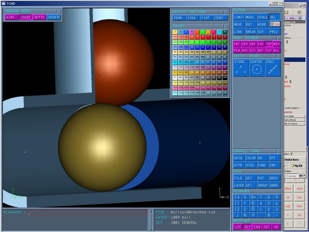

    I'll let some pictures speak for themselves...
    Here you can see a ball at when it starts to fall and a ball half way into the breech. I think we can definitely say with a ball half way in this would be the worst point possible for the bolt to start coming forwards.

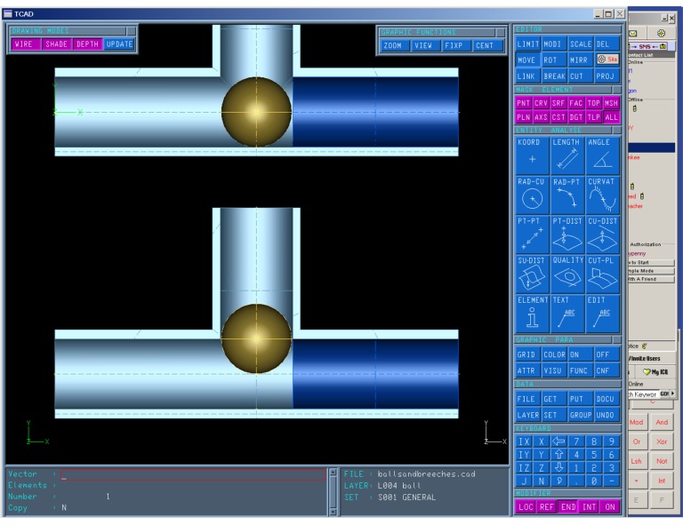

    Here you can see a ball 3/4 of the way in. You can see even now if the bolt starts moving it is very likely to pinch/chop the ball.

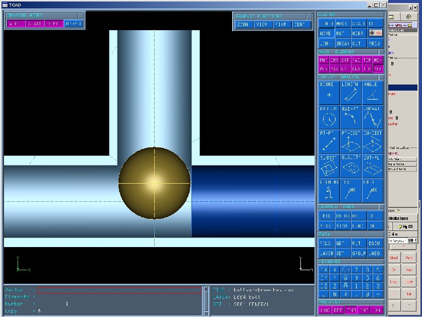

    You can see when a ball is fully chambered that the closest point to the front of the breech is not actually very far, this is due to the shape of a sphere.

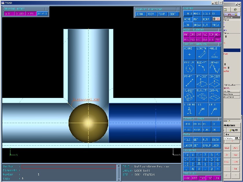

    Below you can see that with the ball almost fed all the way in the bolt is still only able to come forwards 3mm without starting to pinch and chop the ball...

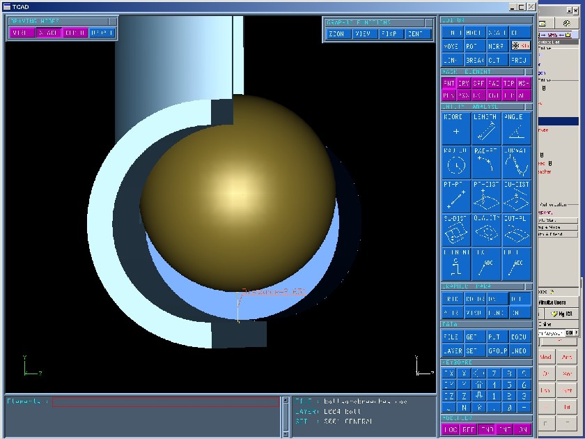

    Here you can see it from the front and see just how likely that ball is to be chopped.
