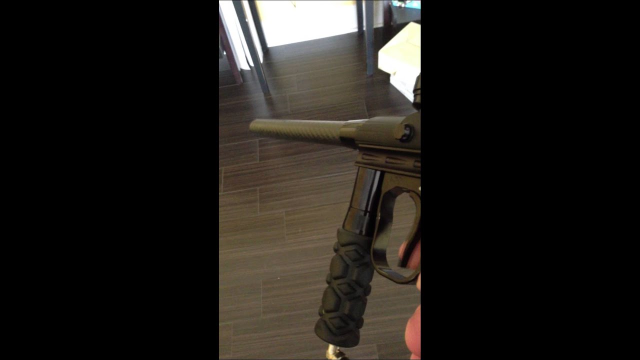

I'v had the opposite experience with a Benchmark on my old RT valved Minimag. That beast would RT like a charm at 900psi or more, and was easy to sweetspot with that longer pull.Originally posted by burscott View PostA benchmark frame with the fat trigger pretty much eliminates that RT effect since it moves the sear differently. At least that's been my experience. Here is the type of frame I'm talking about on a micromag.
It really is all dependent on the valve. Even though internally they are the exact same, they each have a personality.
