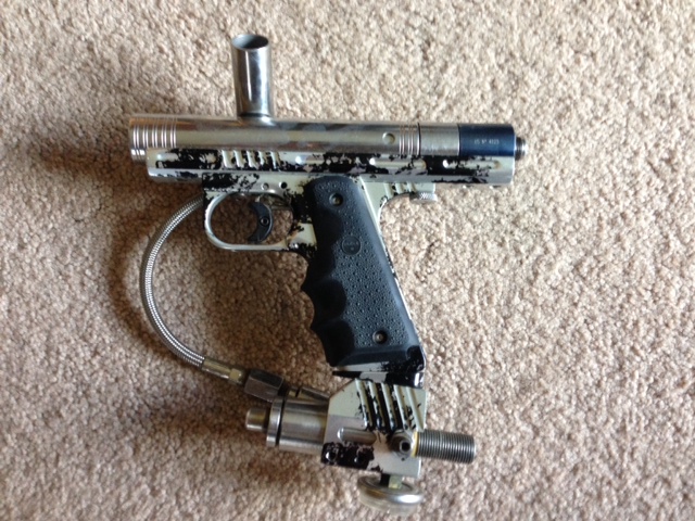

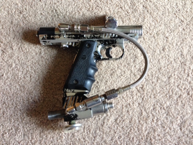

    Played last weekend for the first time in 10+ years... Mom sent out my old mag from back in day and it needs some love. What parts do I need to get this going? Click image for larger version

    probably just some new o-rings and some oil! things are tanks, man...
      AO's Problem Child
      • 7199
      put on a ASA and get a new tank
      • blackdeath1k
        • 2436
        Or a bottle on that reg. It may fire fine with oil. I'd have a parts kit coming for it though.
        • athomas
          Of course it works-its AGD
          • 8039
          Check the orings. The regulator seat oring will need to be replaced, especially if you take the valve apart. They get hard and the regulator pin assembly as well as the back half sealing edge won't line up properly with the indentations created by use, once it is disturbed.
          A rebuild kit is probably a good place to start. That way you know everything is fresh.
