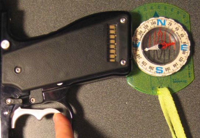

    If it is doing it with the valve installed but not with the valve out, it may be one of three things. (1) Trigger bounce. (2) HES retriggering (3) A leaking on-off area.
    - Make sure the trigger rod isn't hitting the back of the trigger.
    - Make sure the trigger is stable enough that it isn't bouncing due to the valve firing. You may need to make the upper trigger magnet stronger.
    - The collapse of the solenoid field may retrigger the HES if the trigger is in the right place. You might mitigate this by changing the polarity of the solenoid. You can check the polarity of the solenoid by placing a compase at the base of the grip frame. As you pull the trigger and the solenoid engages, the north tip of the compass will point away from the grip frame. See pic:Click image for larger version
Name:	solenoid orientation.jpg
    - make sure the on-off orings are good and that the pin is working properly.
    The on-off is probably not your issue and can be verified if it is working ok in mechanical mode.
    Increase your fix value above 35 to eliminate the HES retriggering issue if that is causing an issue and the solenoid is wired properly.

    What is your fix at?
    Is the trigger rod hitting the back of the trigger? I always back them out a bit shorter than spec because with Xmod it bounces.
    Also, adjust the trigger pull to be a bit longer. After watching the clip on a monitor its hard to tell but the trigger looks real short. Also - how is the magnet above the trigger shimmed? Dont shim it any more than one oring.
