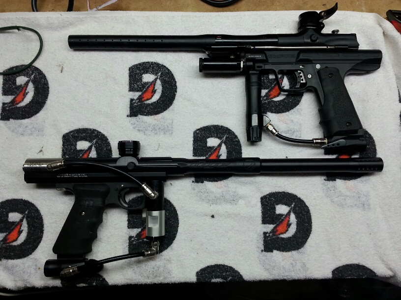

          Again, gun was great, and I had fun rebuilding and playing. Shot some peeps out and got lots of thumbs up from the older guys and weird looks from the kids! ...anyhow...quick pic. Nothing fancy...which is how i like it.
